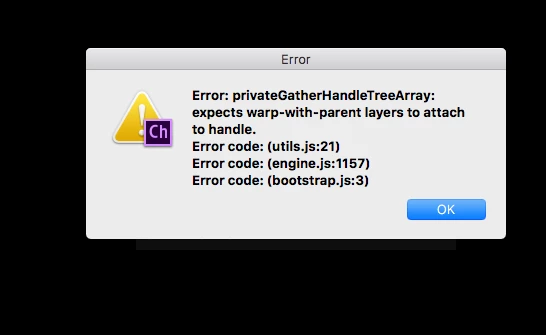

    1- What is this error.
    2-Any tips to avoid dropped fames? My computer has 32g of ram yet i still get dropped frames.

    Did you use the Reset Layer command on a layer by any chance? We've fixed a similar situation in the forthcoming Beta 6. But if you send us your puppet (as suggested above) we'll check to make sure. And also we can look at your dropped frames problem. Note that dropped frames when running live can be avoided by exporting a PNG sequence or dynamic linking into AE/PPro. Of course if it's actual live broadcasting you're doing that won't help you.
