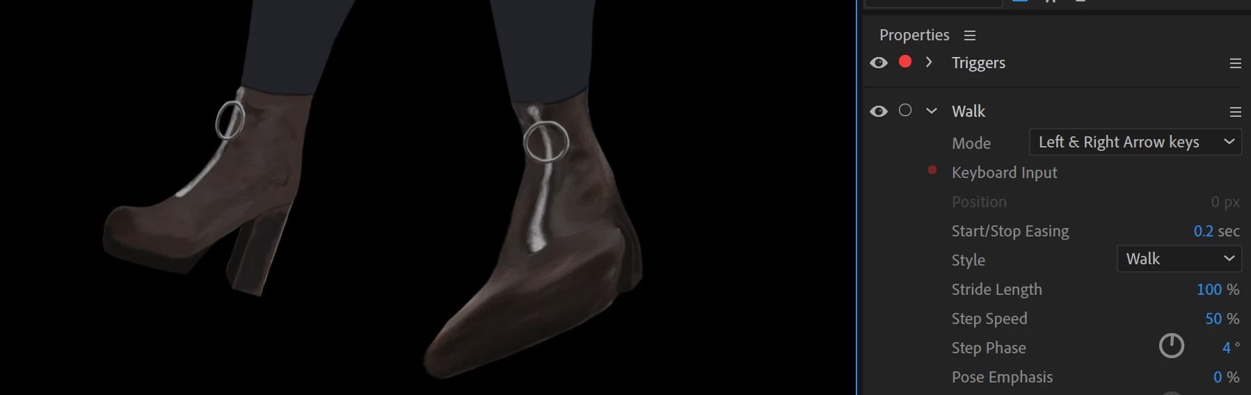

Here's both feet dragged by the ankles. The left foot has a toe, the right foot has no toe...

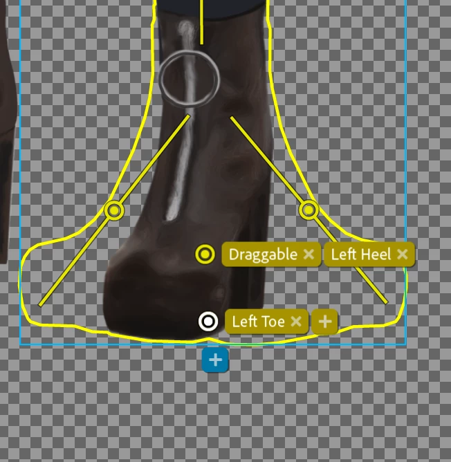

And here's the rigging, based on Hopscotch the frog...

For forward-looking feet like that you might want to just remove the Toe tags completely. Though from the outline shown there, it looks like you have sideways-pointing toes too. So you might want separate views for left/frontal/right so that you can have the Toe tags in different positions for each view (with none in the frontal view).
If you share the .puppet file with me via DM we can look at the rigging to give a better answer as to why the Toes would be stuck like that even when Walk is off.
