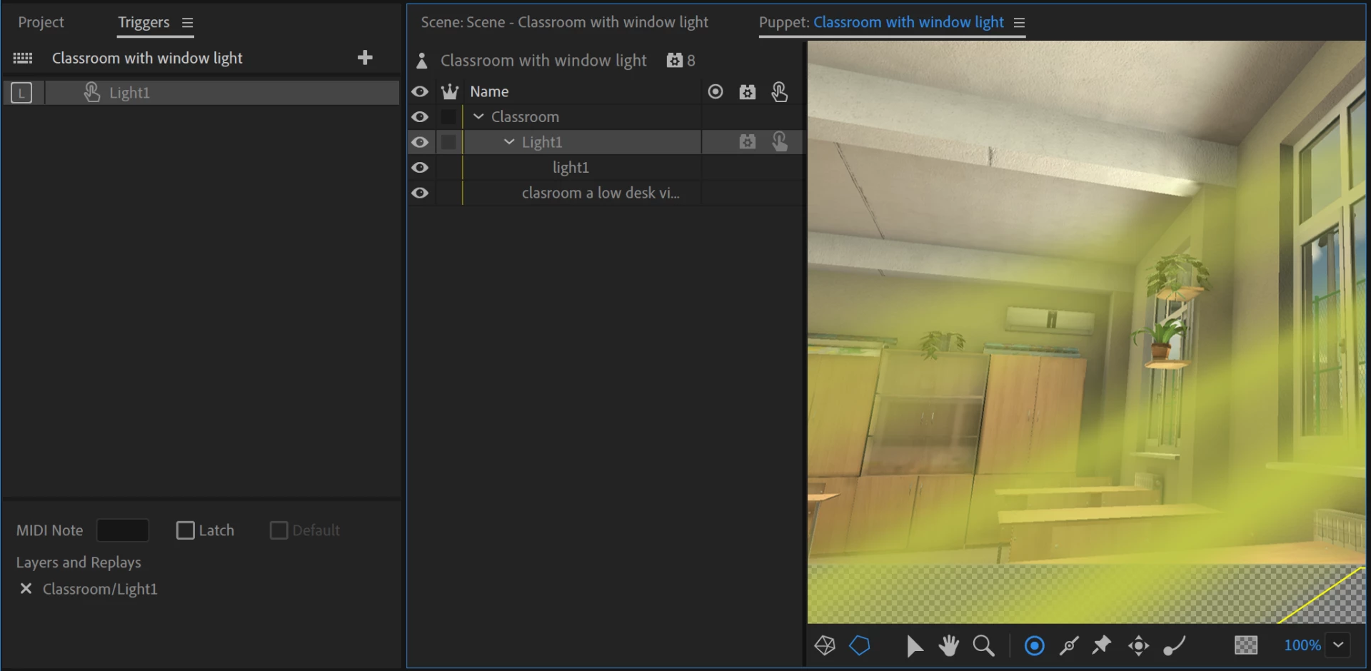

    I forgot I was going to try and give this a go. Here is a plain trigger. Pressing "L" makes the light through the window appear. Note that "default" cannot be turned on, so you cannot make it "on by default". Even selecting latch you cannot make it on by default. (You can submit feature requests by the way!)

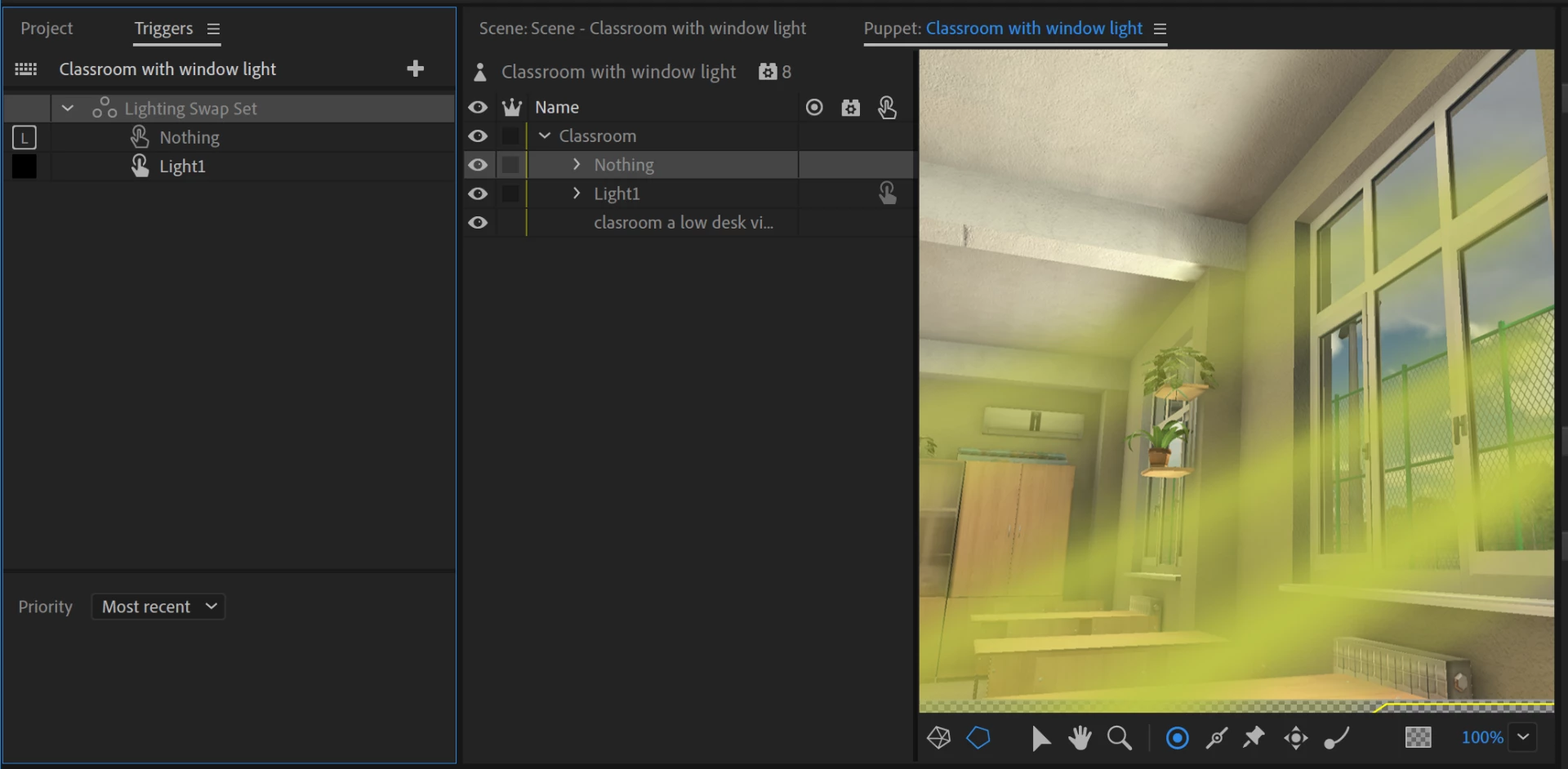

    Here is a swapset added. I created another empty layer in the artwork, then added the light and "nothing" layers into a swapset. I then put the "L" for light on the "nothing" layer, and made the Light the default selection for the swapset. This then works - pressing "L" makes the light go away rather than appear.

    However you can create a swap set with different triggers in it. You can create an empty layer and the eyeglass layer, then make the glasses layer the default. So you are not turning it off as much as swapping it with an alternative that just happened to be nothing (an empty layer). That way it can start on, but you can turn it off.
    Slightly clumsy maybe, but I think it would achieve what you want. I normally create a sub-group per swapset to make the purpose easier to understand.
