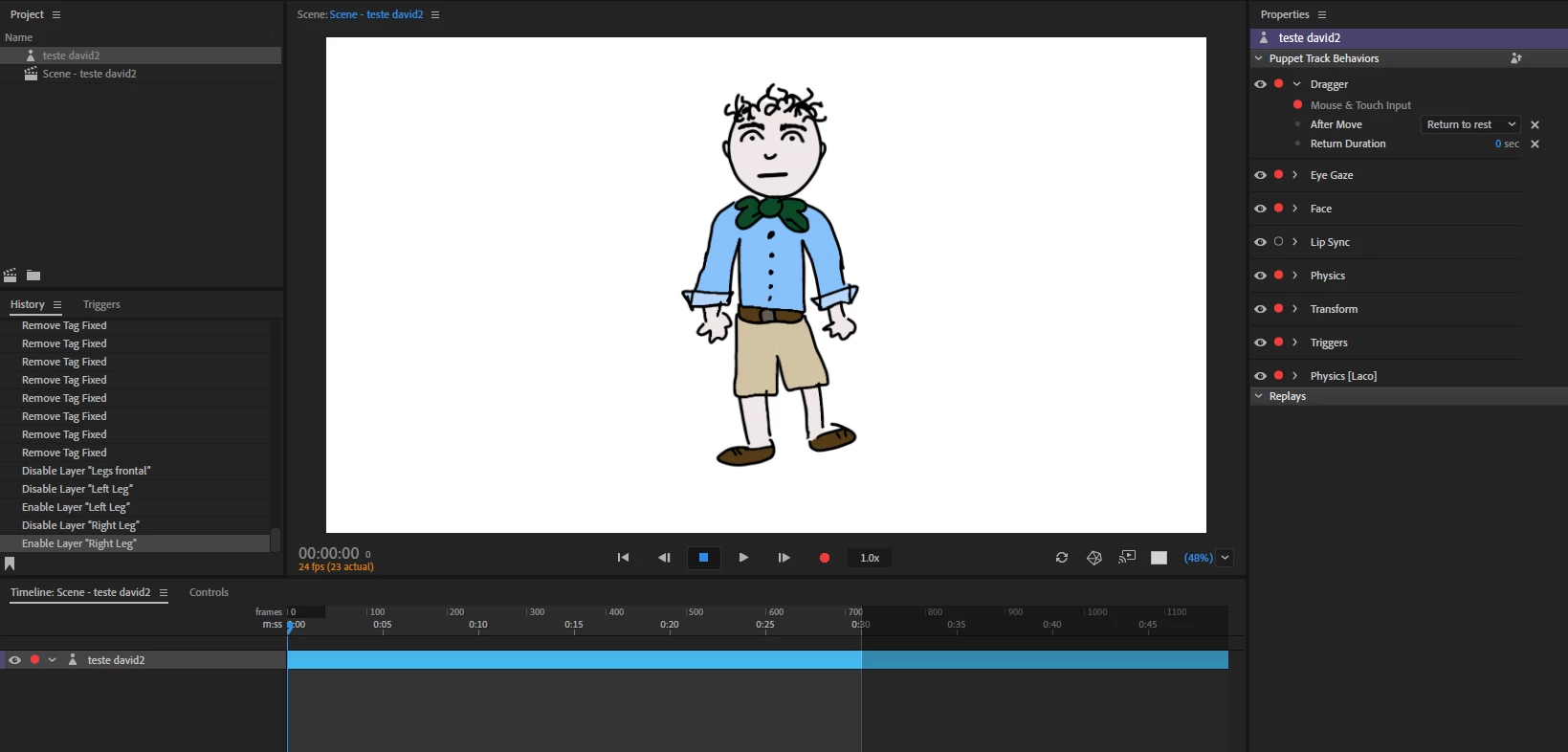

I am trying to do a simple animation (still learning) in Character Animator CC 2019. My puppet is working fine, also my scene including dangles, physics and triggers but as soon as I try to start to record, it all stops working. I have the right puppet (there is only one) selected in the timeline and I think that I have everything that is supposed to be armed, armed in the properties.

Hello, first off thank you for your response.
Meanwhile I already got a webcam to try, because even the adobe employee I asked for help through the chat told me that I needed it... and it still does not work.
I am sending a screenshot.
While it is paused everything works fine but when I try recording nothing reacts...

Hmm, well you definitely don't need a webcam. Try this: Switch to the Start workspace and open a template puppet like Dr. Applesmith, which has draggers. Don't do anything except start a recording, which should allow you to record the dragger movement.
If this works then there's something off with your puppet or settings. If it doesn't work then there's a different issue going on.
What are the physics controlling on your puppet? Have you tried disarming every behavior except the Dragger? That will also narrow down things if there's a conflict.
