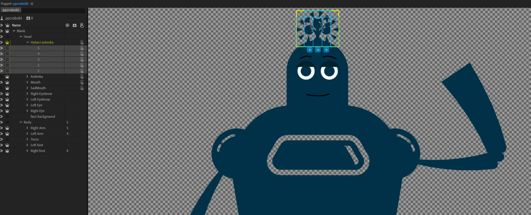

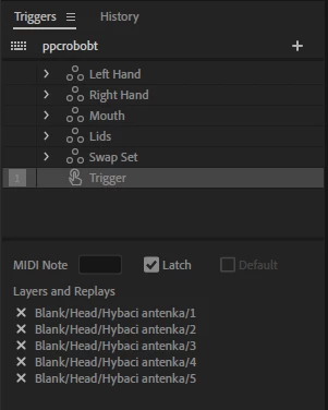

    I use triggers with illustrator all the time. Triggers should not be affected by artwork type. It is more likely to be triggers are not enabled in the puppet, or something like that. Can you provide a screenshot of the rigging panel showing how you have set up the trigger? Then the timeline and scene panel showing how you are trying to use one?
    sweniatAuthor
    Aug 5, 2019 7:32 AM UTC
    Okay, so I think the problem is somewhere in some settings. I have a robot, that can move the antenna on his head. I have only set a trigger, nothing else.
