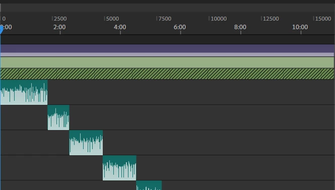

I am trying to export an 11 min scene from CA but every time I try to export it, it will only export 2 seconds of the scene. I have already set the duration of the scene to 11 minutes so I am confused. This is my first time encountering this issue.

I don't see it in your screenshot, but it sounds like the Work Area is set to two seconds. Try unchecking Timeline > Enable Work Area, or click on the work area bar (just above the timeline ruler) to toggle it off. Or adjust it to the length you want to export.
