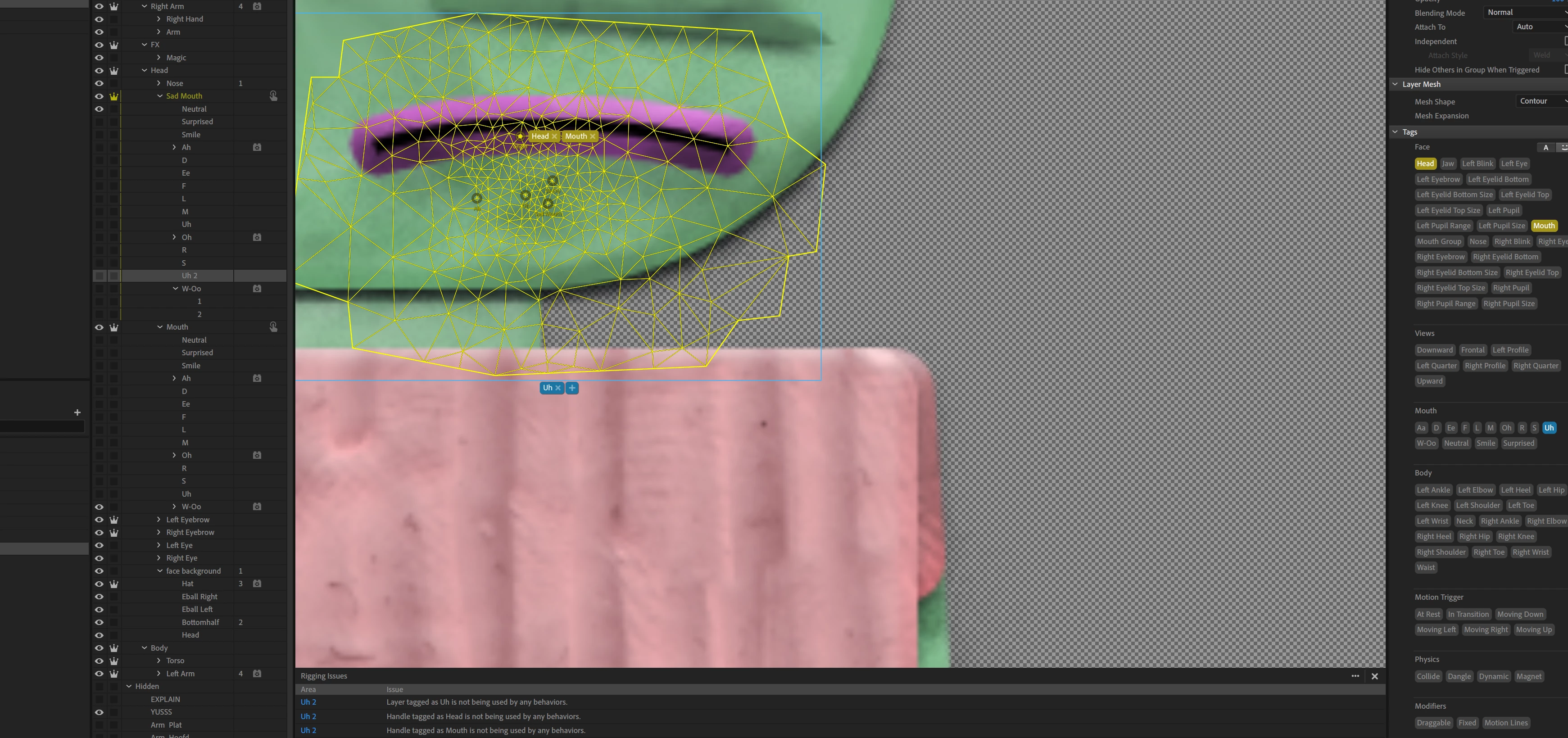

I have a alternative "sad" mouth group hooked up with a trigger/switch. That works!
The problem is that all the viseme's are working except for the "Uh"sound. It's tagged exactly the same way as all the other sounds (which work). I've downloaded Bluster and Almasol puppets to check the diffrences but couldn't find any. The rigging isues is telling me "Layer tagged as Uh is not being used by any behaviors". Why does the Face Behavior know how to work with my other layers but not my Uh layer?
Thanks in advance,
Bas
alank99101739
Apr 11, 2020 9:59 AM UTC
Looking at the tags (on the right) it looks like you Uh layer may also have Head and Mouth tags on it. Try removing them first. The "Head" layer should have the Head tag, the "Sad Mouth" should have a "Mouth" tag, then "Uh" should just have the "Uh" tag. Extra tags can confuse it. That is my guess anyway!
Apr 11, 2020 12:21 PM UTC
Thanks for your reply. Although it didn't solve the problem me, it did help!
I went over my project again after reading your comment and discovered the mistake made by me. I had 2 Uh layers in the same group because I forgot I already made one. Thanks for replying! And I will leave this up for any other fools like me to learn from. 😄
