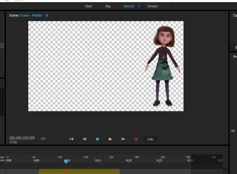

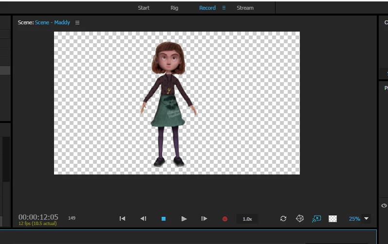

abdulwahedf99870381
Aug 4, 2017 10:05 PM UTC
I did it but after every play position of puppet in the same frame was changed and this 2 screenshot is the identical frame but 2 play .As you say i start from frame 1 and dont change anything.
I capture a movie for help to understand
oksamurai
Aug 7, 2017 4:57 PM UTC
I think you have too many things armed (red dots) on the right. If it's red it means it's looking for new data and that might override what you've recorded. If you disarmed Transform and Walk does it give you consistent results?
abdulwahedf99870381
Aug 4, 2017 9:01 AM UTC
this link was helpful for me and i turn on style and walk in it  but i still have the same problem the position of puppet is changing after every play of my record and when i play from frame 1 the position stay in the last position and when i start playing, the recording of my puppet start from that position . i use the refresh button but after every play from first position the position of my puppet change in the last position
for example after the first play this is the first position
after refresh it and play again this is second screenshot
and you see all two screenshots are one position but after every play the position change
what do i do?
oksamurai
Aug 4, 2017 4:26 PM UTC
When you refresh, it should move the character back to the "original" position, wherever position x/y placement is. To see the whole thing as intended, you'll have to go back to the start of the timeline.
