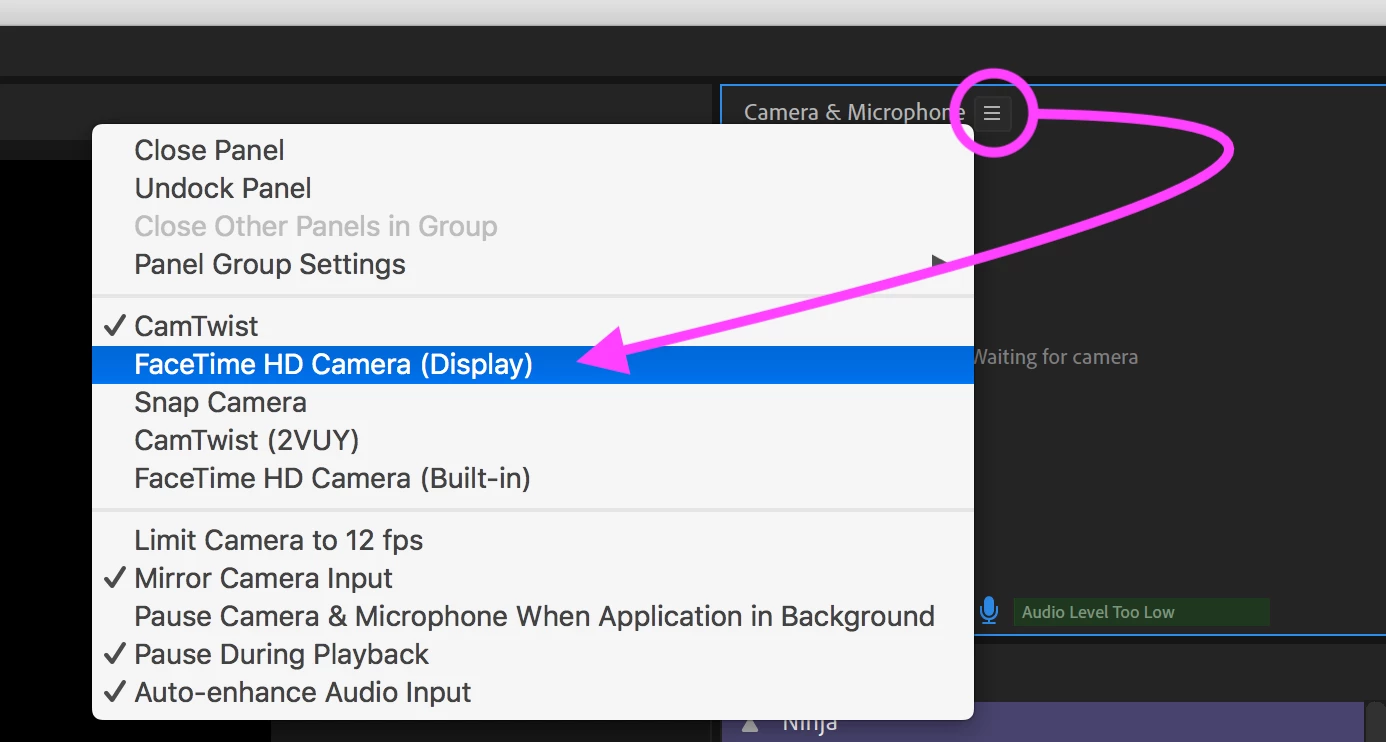

    I got this message in the Camera & Microphone panel after installing CamTwist which adds camera options.
    Try changing the current camera in the Camera & Microphone pop-up menu.

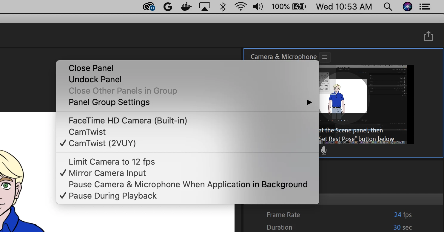

    Apr 15, 2020 5:57 PM UTC
    I just did a quick test with CamTwist. For a video source in CamTwist I was sharing my desktop. I found "CamTwist" jumpy (the source was flickering and not working well) but the "CamTwist (2VUY)" option worked fine. No idea why, but its a different color encoding I think.
    Oh, it also failed when I grabbed my external (higher resolution) monitor. CH did not work then. So CH might have an upper bound on resolution it supports perhaps. I did not play with limiting to 12fps etc settings, just sharing that CH can read from CamTwist - but you might need to fiddle with settings.
