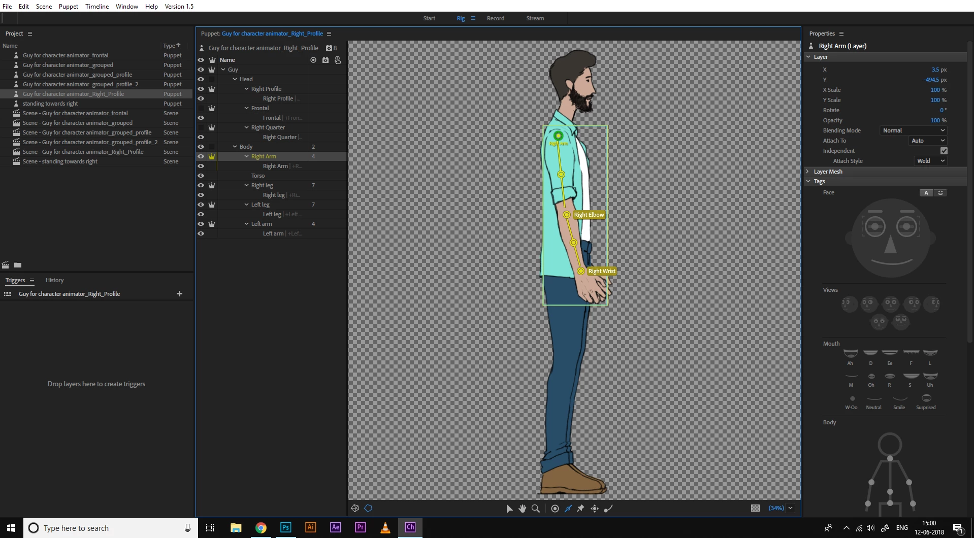

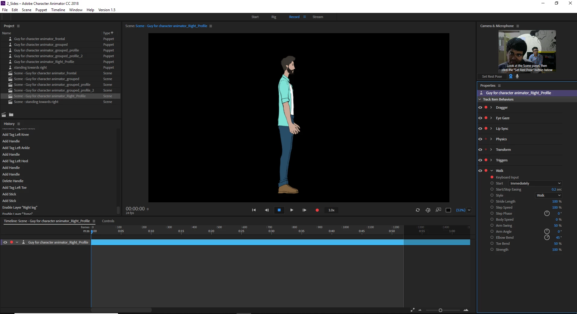

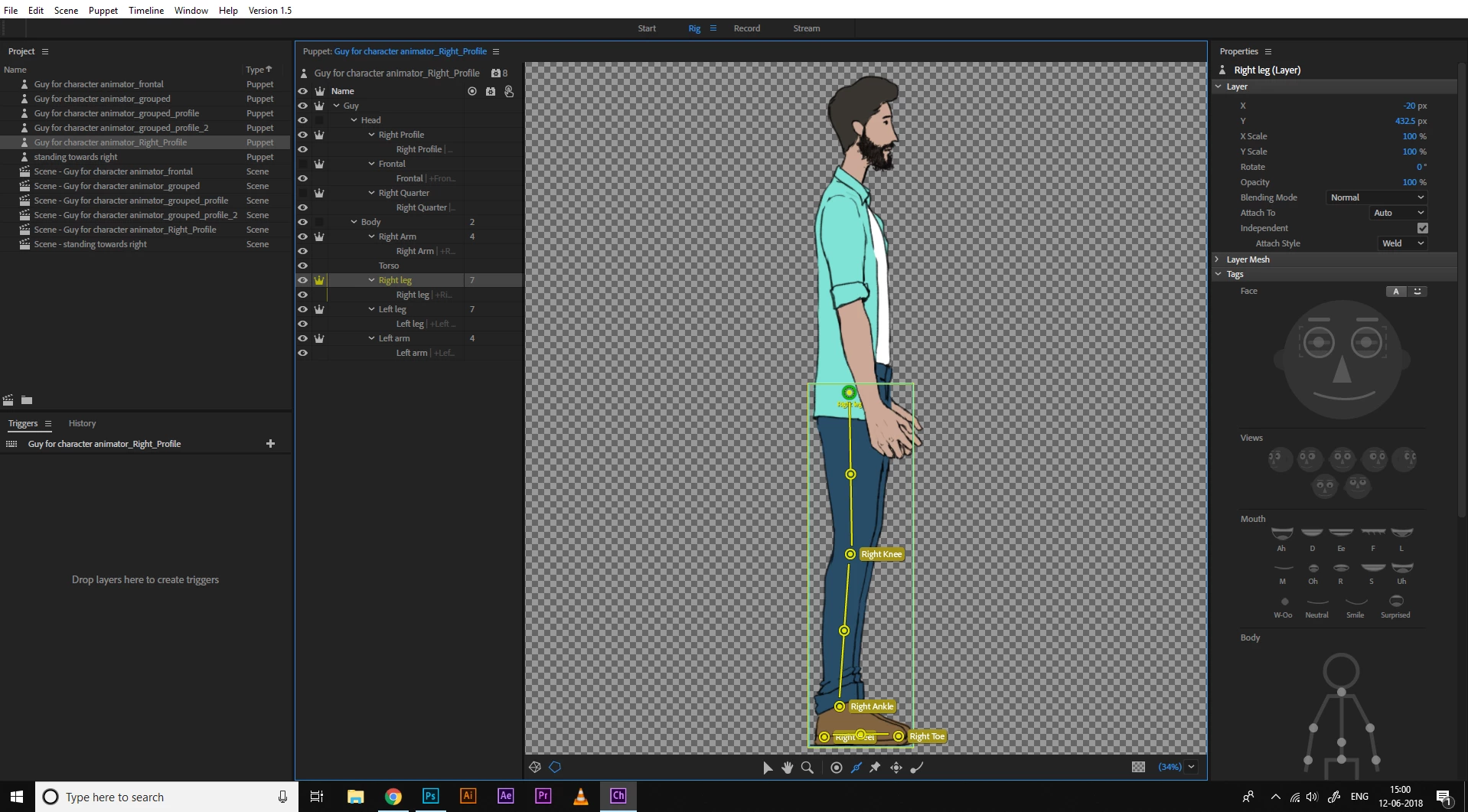

We have rigged a puppet guy and enabled the walk behavior, but the puppet is not moving. The rigging has been performed by keeping the Maddie tutorial as a reference.
Is there any problem with the layering or rigging?. Any help on the same would be greatly appreciated.
Please find screenshots below for reference.

It's possible it's not in the rigging.
I don't know if this will answer your question, but under the walk cycle, you need to set the body speed so that it actually moves. I would suggest actually recording it, because if you don't, then every time you go back to it (at least for me) it defaults to zero body speed. Make sure some of the other parameters are also set.
