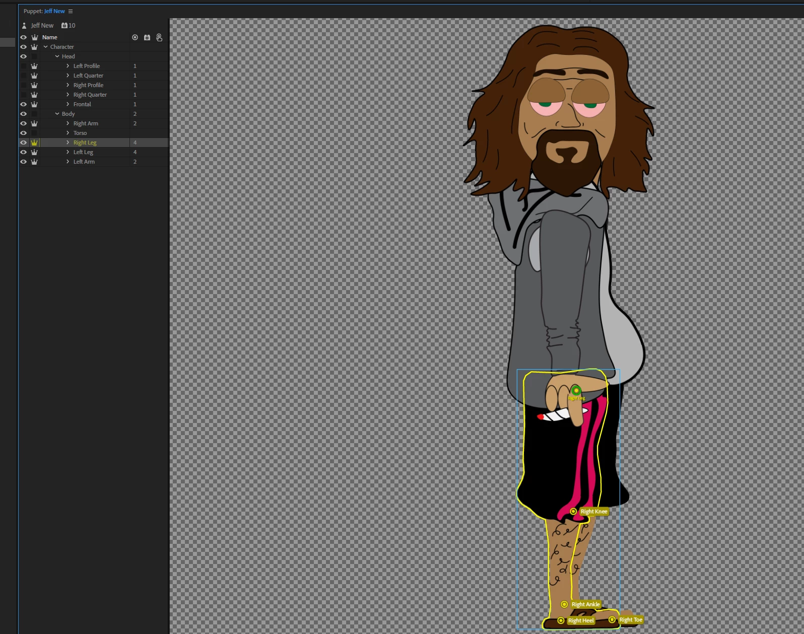

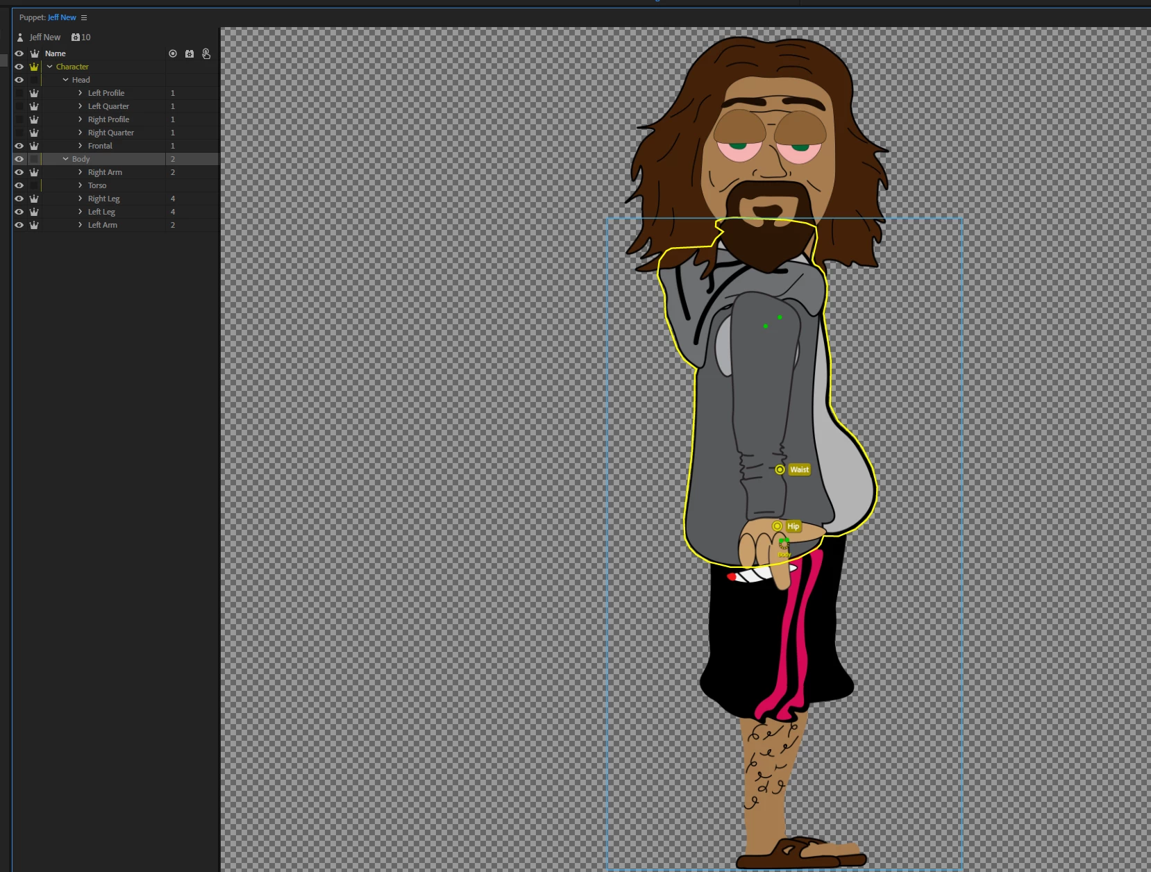

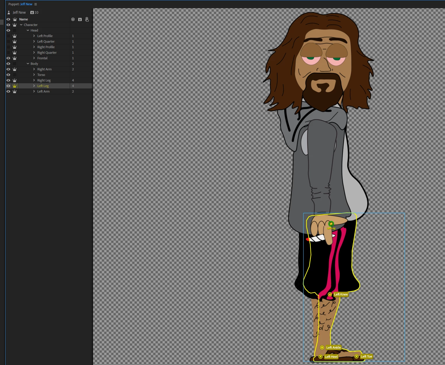

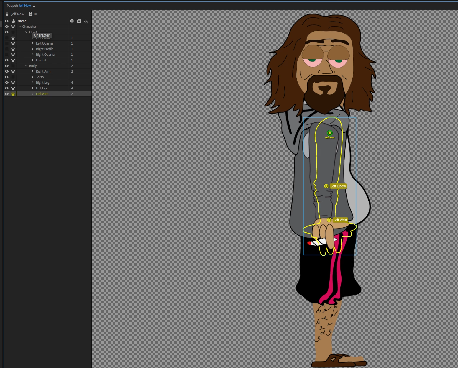

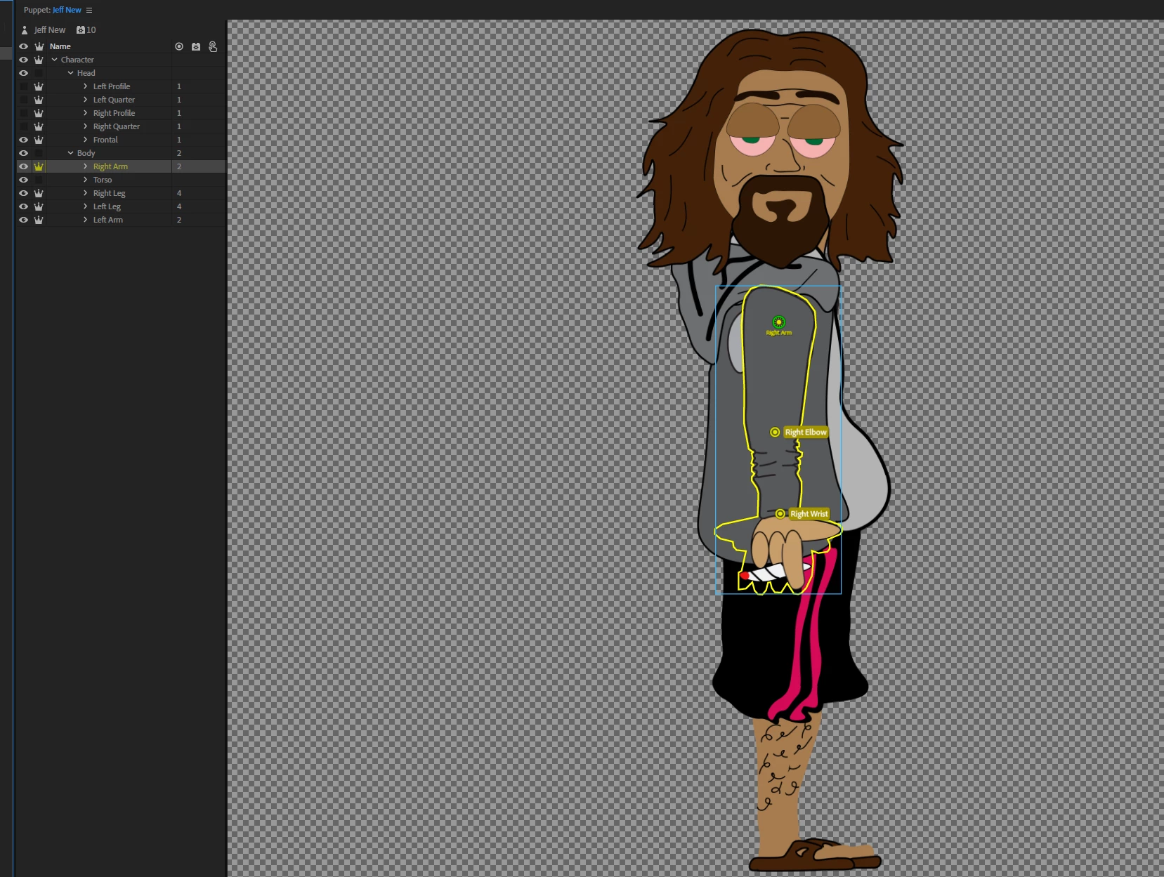

Can you share the puppet? Or a screenshot of the rigging?
Sep 12, 2018 5:56 AM UTC
alank99101739
Sep 12, 2018 7:17 AM UTC
Thanks for the screenshots. Hmmm. The basics seem fine - hips and waist, legs seem tagged fine.
Could you show the walk behavior settings? I assume you added the walk behavior to the root of the puppet? (Its not on any of the nested layers.) Is it ”immediate” or “on left/right arrow” to make it walk?
I was going to suggest as an experiment to make a copy of the puppet (e.g. export and then import again) and then delete the head profiles (just leave one). I was wondering if the walk behavior was looking for left/right profiles to use, but found the head profiles and decided to then look for body parts to move under those profiles. Because you don’t have left/right/frontal profiles for the walk profile, maybe it picked your head.
So either try deleting the head profiles as an experiment, or wrap the whole body in another layer of left profile so the walk behavior finds that above the body...
But I am not sure what is wrong. Your screenshots seem sane. The above is my best guess at the moment.
