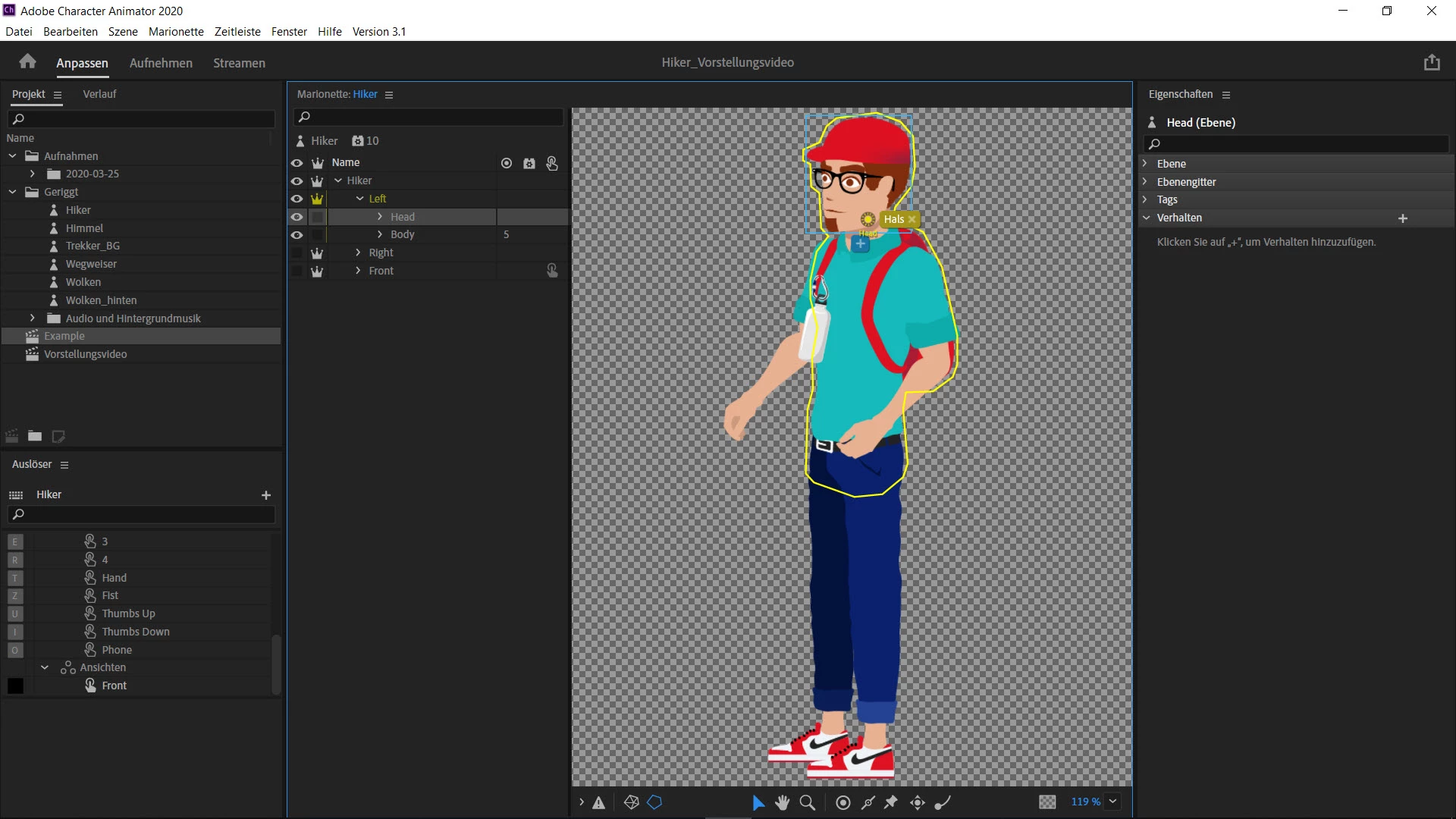

I have a question about the walk of the characters. We drew a character with 3 views. Our problem is, that when we do the rigging exactly like in the video, the character is a bit smaller while walking. When it stops, it grows up and the character is bigger again. On the left side the problem is more pronounced than on the right. Is there some special rigging that counteracts this? Here are some screenshots and an example video of the problem, we can't solve. Thank you for your answer!
Thats the height of the character while walking which is smaller.
And here he's standing and bigger.
I have you a little video to see what i mean further down.

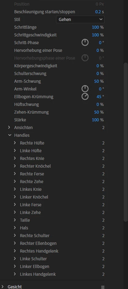

I cannot view the view on my iPad sorry, but could you share a screen shot of the rigging panel? The position of Head, Neck, Waist, Hips etc handles is very important. Sometimes moving them around relative to each other and adjusting the walk strength in the behavior can make a big difference.
Sina_01Author
May 1, 2020 8:56 AM UTC
Thank you a lot for your answer...yes of course, I hope that's fine like that.
Walk Panel

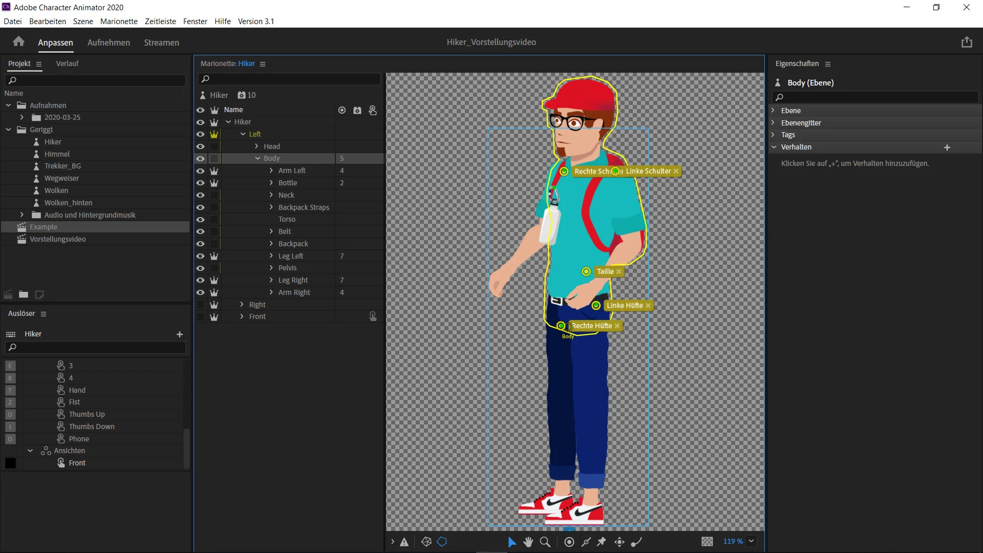

Torso, Waist etc.  
Neckposition

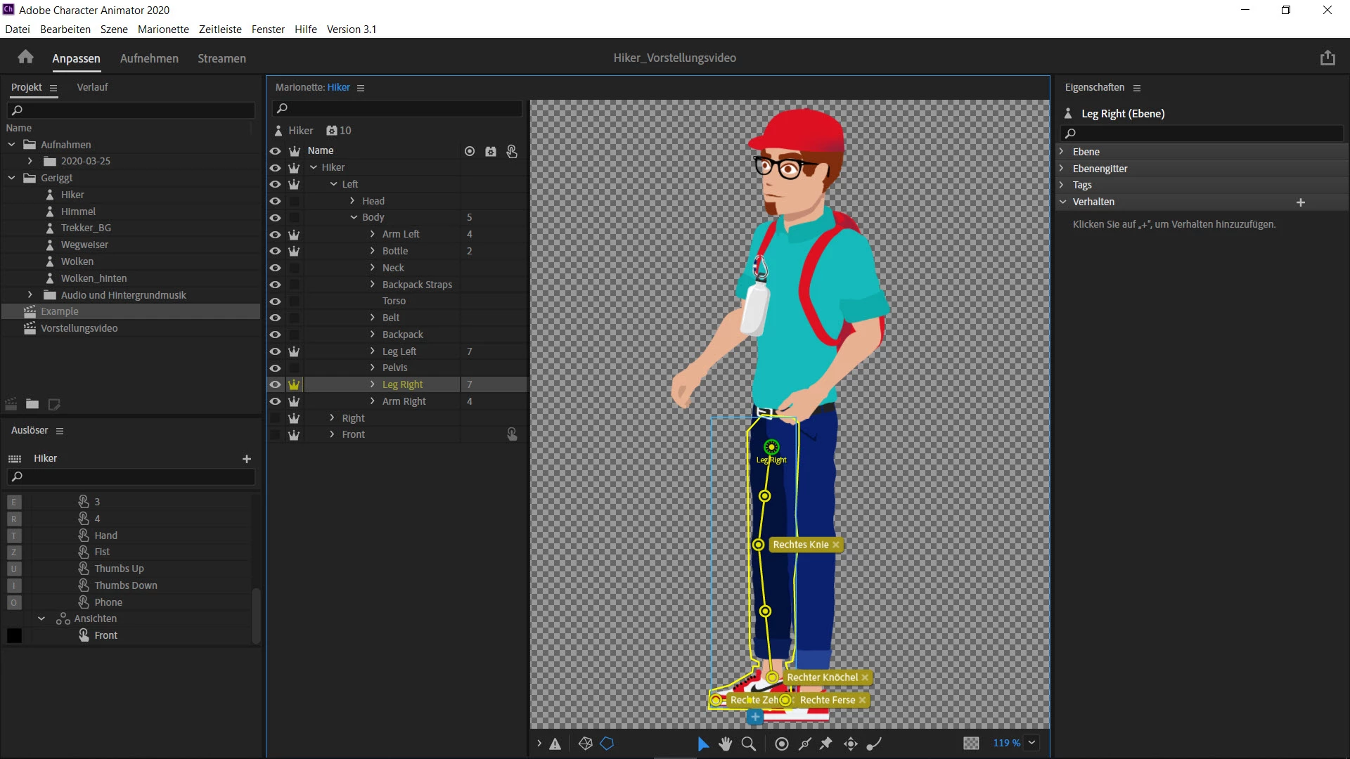

Right Leg

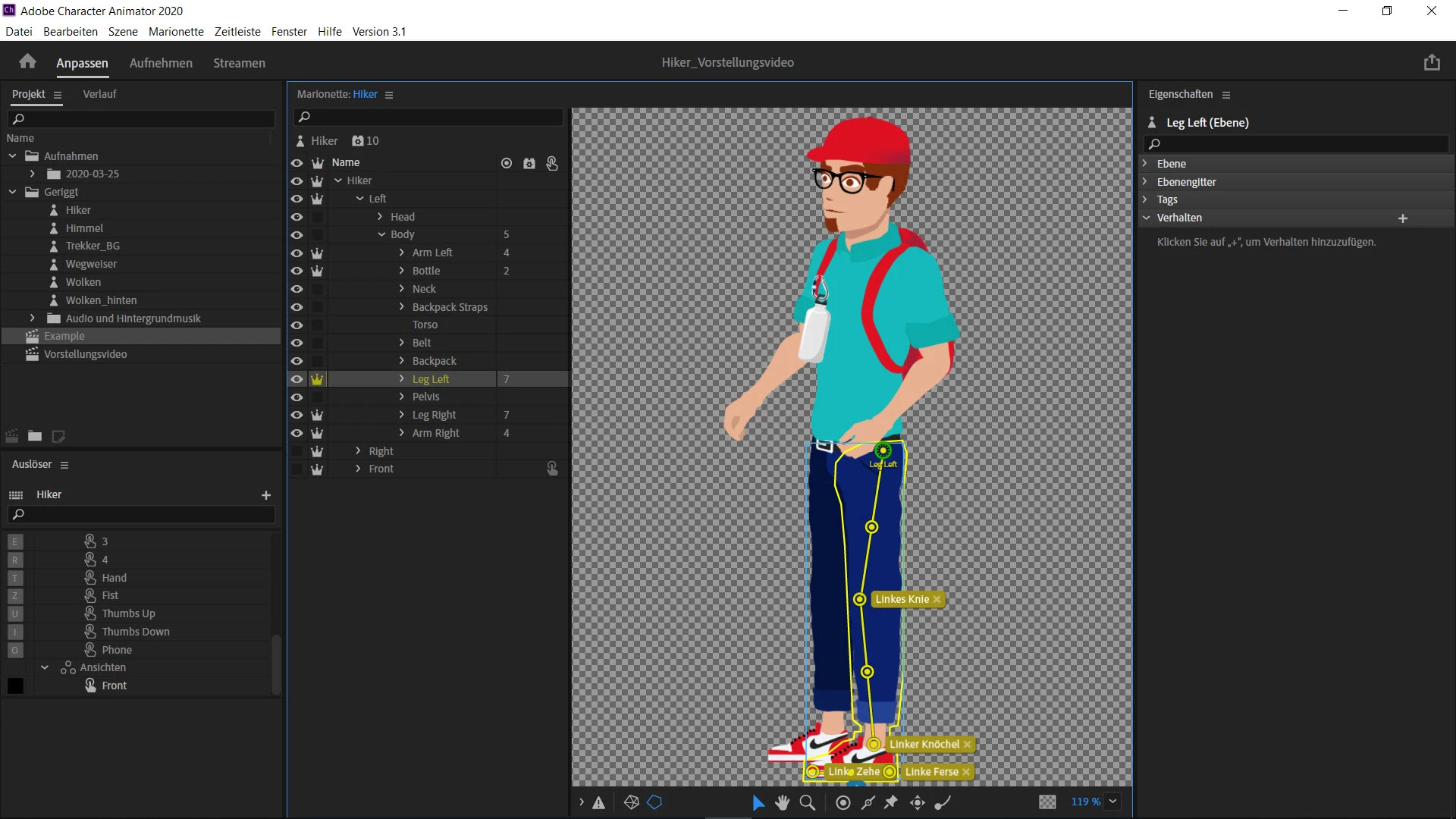

Left Leg
