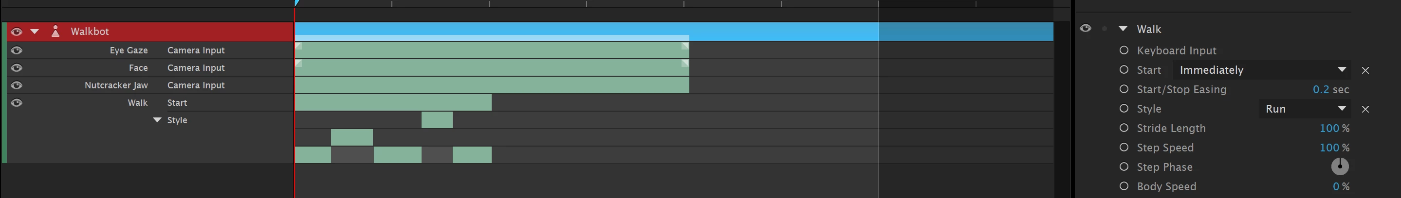

It's a little complicated but you'll need to arm and record "start" as well, and "keyboard input" if you're using the arrow keys. Without those, CH isn't sure when to start/switch.
So here I recorded a start: immediately and style:walk, then two more takes with style:prance and style:run, and it worked.
Not the most intuitive way to do things, agreed - but this should work.

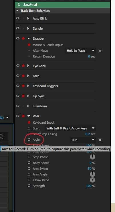

From what I noticed under the "Walk " properties, you need to check if the recording button is active/armed (red). Otherwise if not active/armed, it records  nothing and on playback seems to just play whatever default setting you have whether its a run , walk ..etc. I am not sure if its what you were asking but I am sure Oksamurai will help.
