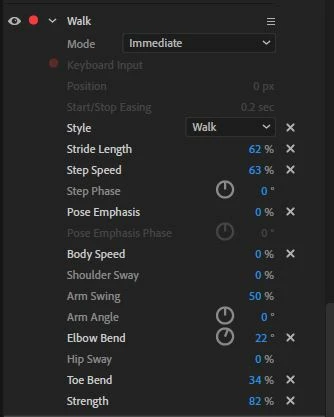

This is my first time trying to make a puppet walk and I have "run" into some issues (pun intended). as you can see in this screen shot of him walking:

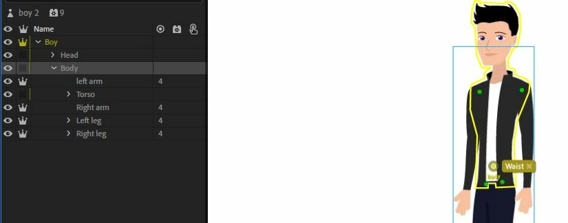

The legs aren't attached and the shoulders aren't attached. Here is what the puppet looks like in rig mode. (after taking the following picture I tried using the pin tool to further try to connect the arms and legs to the body and it didn't make a difference)

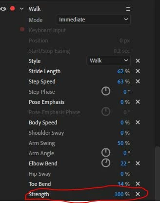

Turning the strength to 100% for walking seems to somewhat help but still it's far from a desired result. It also reveals another problem, the head starts stretching with the neck. I was atempting to follow this youttube tutorial https://www.youtube.com/watch?v=gv_2Upvtm-M
