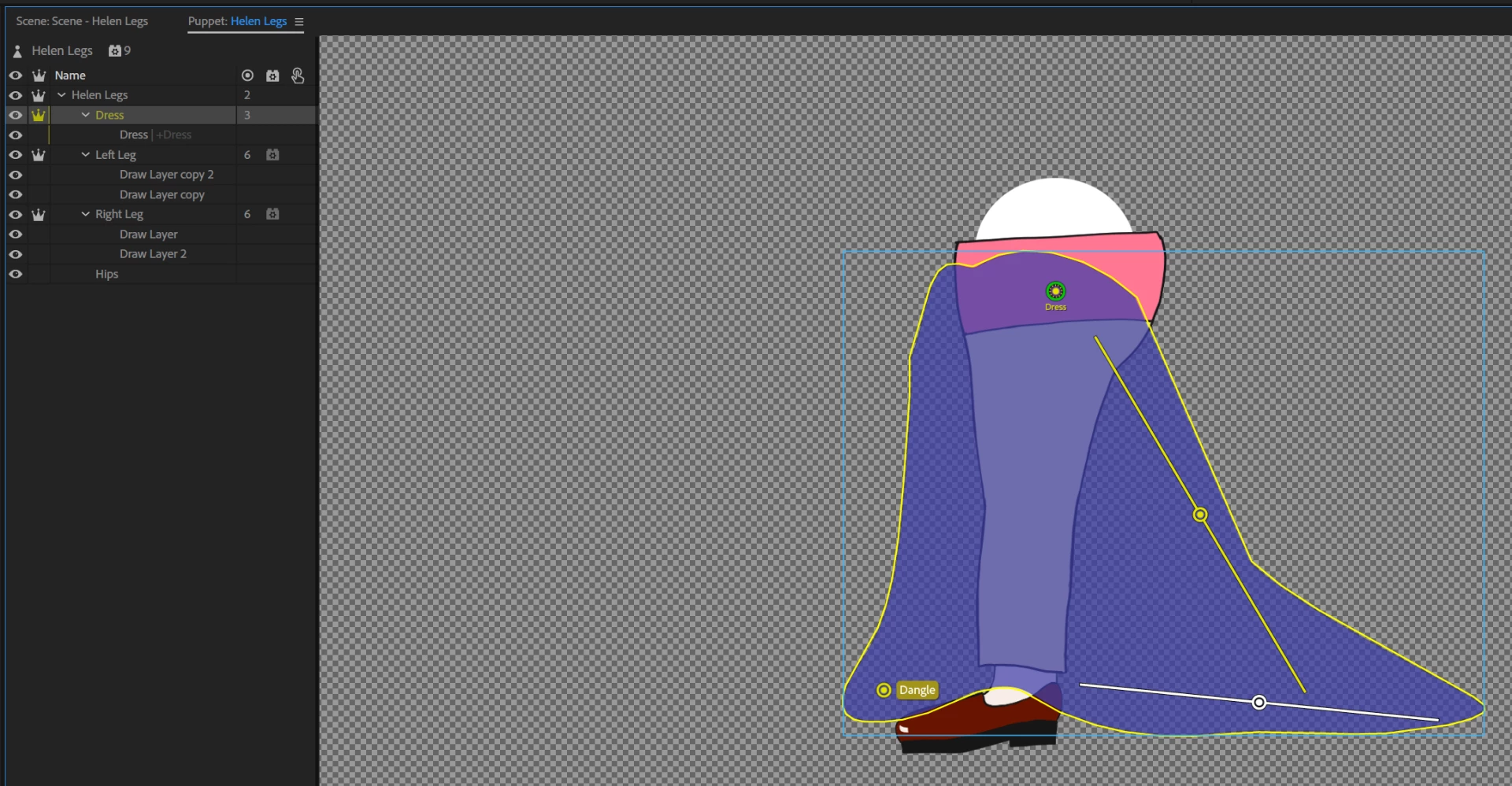

First, I took some legs I had recently and threw on a dress. I attached at the hips, put some sticks to keep the train of the dress more solid (it flopped down otherwise).

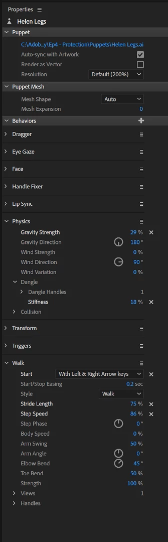

The root layer had the following (physics and walk settings). E.g. I fiddled with the gravity and dangle stiffness, as well as the walk strength.

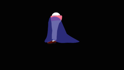

Here is the end result - I faded the legs out as walking along. The dress is transparent in this demo just so you can see the legs move. I am suggesting you hide the legs (click on the eye icon in the puppet) so they are there (to get the walk motion) but not visible (you see the dress instead). Something like that.
Is it better? Not sure. But its another option! I don't know if you can see, but the dress bounce height at the front of the dress so it does not move and and down as much.
