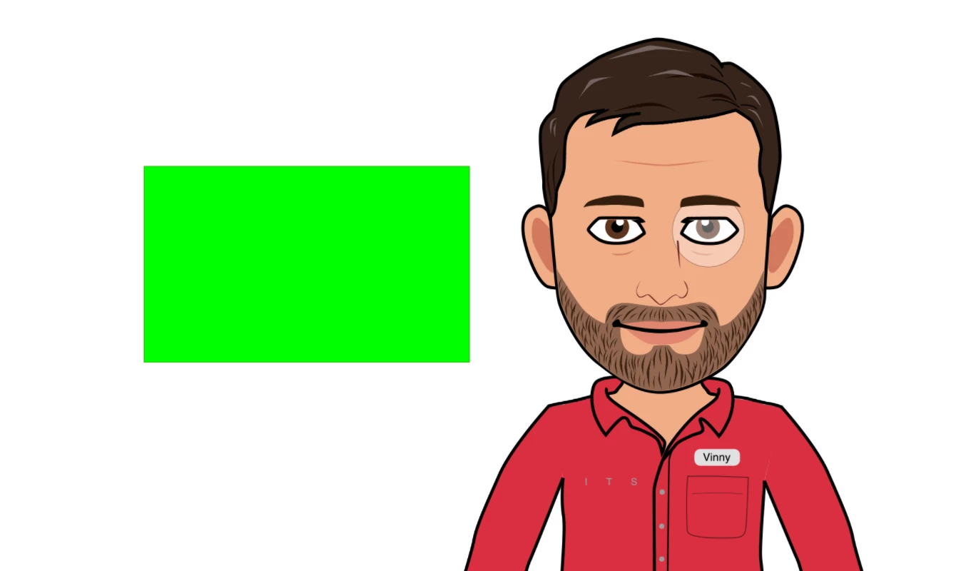

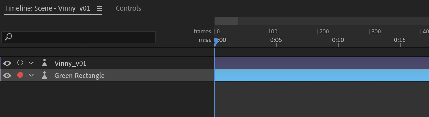

So only solution I know of is to create a solid color rectangle, import as a puppet, and place in the scene behind the character. I think this is better anyway as otherwise you would have to set the setting each time you exported.
Here I imported the rectangle into the project then added it to the scene behind the character.
But it was too small...

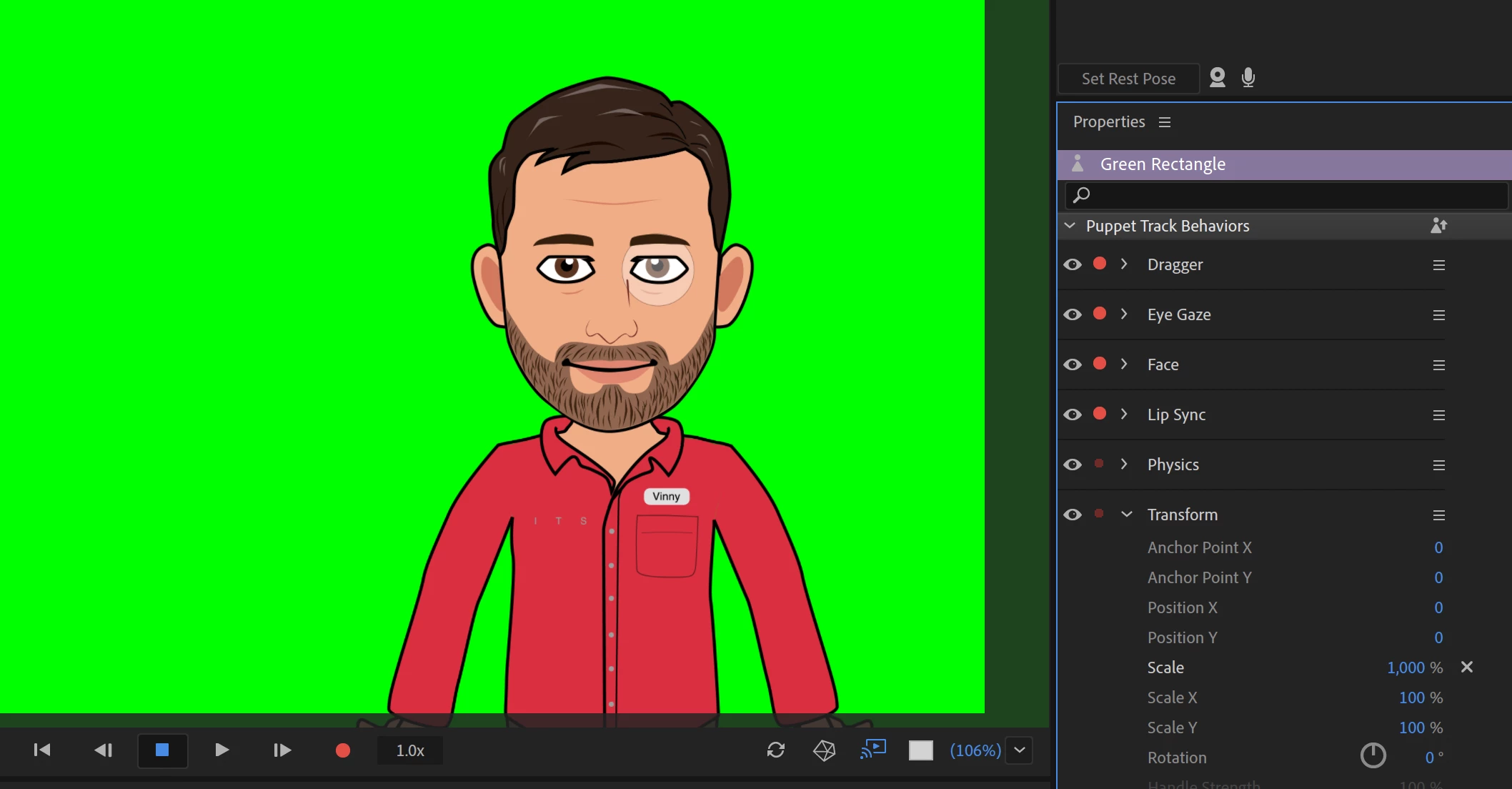

So I went to the Transform behavior and changed the Scale value to something big (default is 100%). I picked 1000% because it was easy to type. Also because I can pan the camera around without running off the edge of the background.
