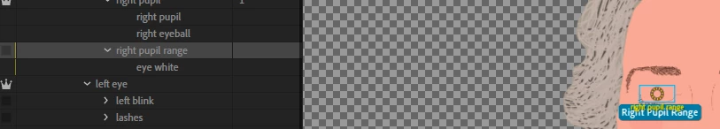

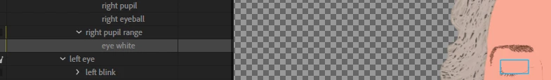

    Dan RamirezCorrect answer
    Feb 1, 2019 12:12 AM UTC
    Now that I've seen the file, I can let everyone know what's going on. The layers tagged "Left/Right Pupil Range"(a layer named left/right eyeball is another way to get a pupil range tag) determine how far the pupils can move and these layers were about the height of the pupils, so our algorithm didn't know what to do. I'll file an internal bug. Perhaps in cases like these they can travel half the pupil's distance or some other sort of arbitrary distance.
    I'd also like to see control over strength of the vertical and horizontal travel because right now you can only control the strength of them together.

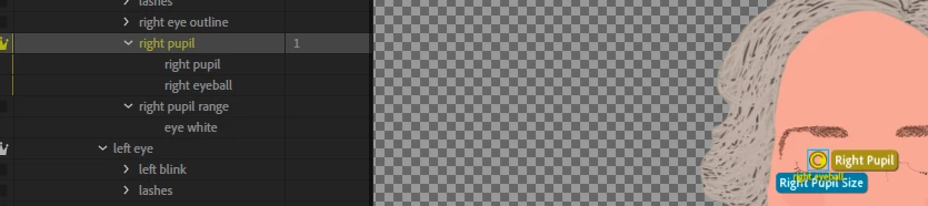

    alank99101739
    Feb 2, 2019 11:22 PM UTC
    You can create a separate layer with say an oval on it that you make invisible Make it bigger than the eyeball. Then put the pupil range tag on that layer Instead of the eyeball layer.
    The idea deal is to give the pupil more freedom to move. My eye debugging blog had an ecample

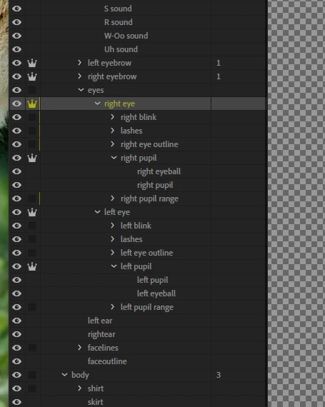

    alank99101739
    Feb 3, 2019 10:33 PM UTC

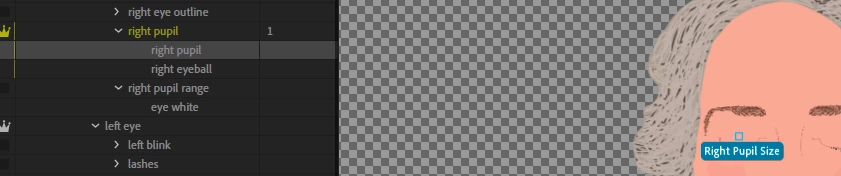

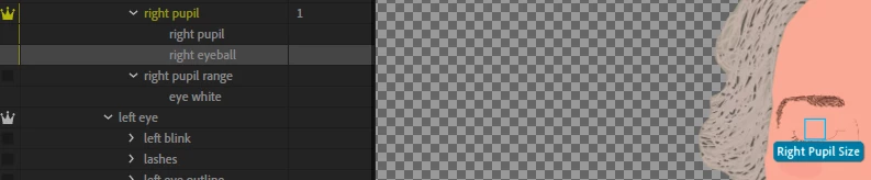

    I notice you have layers like right pupil with a child layer of right pupil. I would only Have one. When it reimported, it can end up tagging both with the right pupil tag, Messing things up. So clean up the names then click on every layer and make sure no stray tags left over.
    eg the right pupil layer has right eyeball under it. So the parent right pupil is probably bigger than the left, so it will not move as freely. That is why one eye moves more than the other (is my guess)

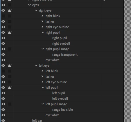

    christineavatar
    Jan 31, 2019 7:57 PM UTC
    Okay alank, I have corrected the problems of labels but the eyes still move inexplicably to the right or left corners.
    But I still get the eyeball going to extremes for no reason. (The left eye has the exact layout.)

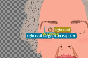

    alank99101739
    Jan 31, 2019 5:42 PM UTC

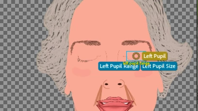

    Pupil size goes on a layer to tell CH how big the pupil is. (Might actually be the iris, but lets not worry about that!). Pupil Range defines the bounding area the pupil can go in. So if Pupil Size is on the same layer as Pupil Range, the eye will not move (there is no space for it to move around in).  E.g. if you have a white circle with a black dot in it, the white could be the Pupil Range, the back dot would be tagged as Pupil Size. You can also fiddle with strength to limit it a bit.
    If however you want the pupil to go outside the white area (e.g. its a large colored iris), then it can be helpful to create a separate circle for the Pupil Range and make it invisible. Gives you more control.
    If you have excess tags - multiple objects with “Left Pupil Range” and “Left Pupil Size” then CH can go crazy. Same problem if you have non-contiguous artwork in those layers. CH does it best to work out what the eye is, but the eye can sort of jump between the areas. So you need to get those tags exactly right. Pupils can start going backwards for example if wrong. I think the internal maths goes negative at times or something. So I would strongly encourage you to make sure there is only one Left Pupil Size and only one Left Pupil Range tag in your puppet (And same for Right). Multiple tags can cause lots of problems.
    christineavatar
    Jan 30, 2019 9:39 PM UTC
    I could not post the puppet here as it is not allowed to go this way. I could do it on a cloud system.
    I have taken my glasses on and off but it doesn't have any effect on the puppet. The eyes still get really hyper-active with looking out the corners. The one oddity I could find was that both the right and left eyes there was a marking of 'right pupil size' 'left pupil size' on both pupils and pupil ranges.
    I don't have any idea what pupil size means but I don't think I want it in there, do I?
