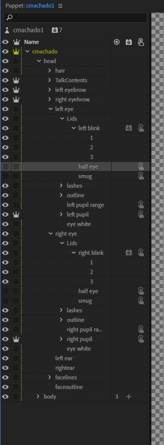

    alank99101739
    May 16, 2019 7:32 PM UTC
    Yes, perfect. That is the rigging hierarchy I was after.
    Just checking you turned off the camera for eye tracking on purpose (eye has to be moved with mouse)?
    Also, have you tried turning off eye snap? Just to see what happens.
    I could not see where the mouth was. Which layer is it under?
    As another experiment, you could try turning on independence for “left eye” and “right eye”. I am just wondering if the mouth swap set is “taking over” somehow, stopping eye movement.
    Okay, another suggestion. There is the lipsync behavior on the panel. If you expand it, is there a “views” or “handles” section you can expand? If you look in there I think it will show all the visemes and the layers they are bound to. Just check there is not some strange linking going on you did not expect. Autotagging sometimes tags something you don’t expect. Then when the lipsync starts changing the mouth, it might lock down the sibling layers.

    I hope this is what you meant by 'rigging hierarchy':
    Yes, I have rigged all the behaviors but I still deal with the no blinking.

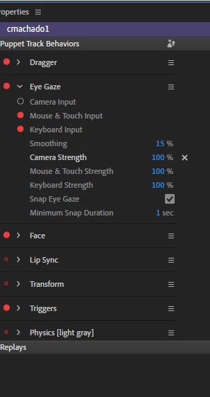

    May 15, 2019 12:37 AM UTC
    To be clear, the eyes worked before the soundtrack was added?
    Can you share a screenshot of the rigging hierarchy of the puppet?
    I assume you arm the eye gaze behavior in the scene when attempting to record the scene. Sometimes if you click around the place it might turn it off and you need to turn it back on if you want to record it. The red dot should be on in the timeline against the eye gaze behavior.
