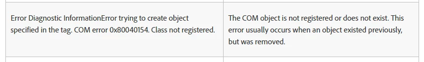

Coldfusion 2016 with all update installed on windows server 2016 (obviuosly 64 bit),
I can't use a registered 64-bit dll, which instead used with a simple vbs program correctly. The error reported using cfobject is always the same: An exception occurred when instantiating a COM object. The cause of this exception was that: AutomationException: 0x80040154 - Class not registered. I have checked with every tool and the class is registered,
I have granted permission to access
"everyone" the directory where the dll is installed.
I do not know what to do.
Previously the same dll always with coldfusion 2016 (updatet) but on windows server 2012
worked correctly and I could use it through the cfobject Anyone have any suggestions to give me?

<cfobject type="com" Action="Create" class="AxSms.Gsm" name="objGsm">
