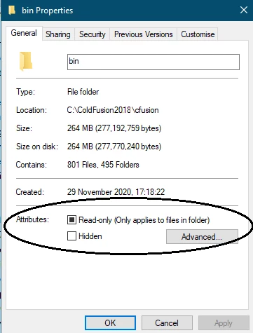

    May 19, 2023 12:19 PM UTC
    Strange. I suspect that something was changed in your ColdFusion 2018 installation.
    I say this because, when ColdFusion is installed, the files in the following directories are Read-Only by default:
    • c:\coldfusion2018\cfusion\bin
      c:\coldfusion2018\cfusion\db\slserver54\bin
      c:\coldfusion2018\cfusion\jetty
      c:\coldfusion2018\cfusion\jnbridge
    Take the first directory, for example. If you navigate to c:\coldfusion2018\cfusion\, right-click on bin and select Properties, you should see something like:
