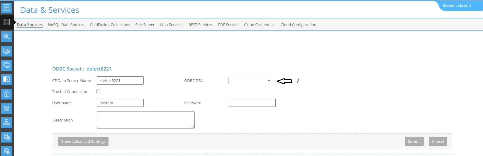

    It is an ODBC system data source. One opens it with a connection string. For example DSN=DataSourceName.

    The data source type, with OpenFusion 2018, was ODBC Socket.  I hope that helps.

    Thanks for your reply. Nevertheless, my questions remain unanswered.
    Both of my questions amount to the following.
    When you configure the ODBC datasources in the ColdFusion Administrator, what values do you use for ODBC DSN?
    How did you set up this ODBC DSN? For the benefit of all, please mention the steps you followed. For example, you mentioned a version 3 driver, and compared it to a version 2.5 driver. This implies that your explanation will begin with a named driver file of a given version.
