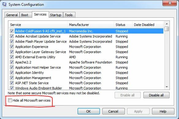

Hi Everyone,
I have received the logs. Please allow us some time to investigate on the issue. I have requested everyone for the Event Viewer Logs (System & Application) as well. Please send them along.
Also, since everyone is using Windows Server 2012 R2, I have a troubleshooting step that can be tried. The suggestion may sound very basic, but it will help us to further isolate the issue.
     1. Start>>Run>>msconfig and click OK
     2. Go to "Services" tab and check the box "Hide all Microsoft services" as shown below.
     3. Click Disable all and click OK. For the changes to take effect, you need to restart the server.
     4. After the system restart, try to start the ColdFusion services from services panel.
     5. If the same fails, try to start it from command prompt as discussed above and share your findings.
Anit Kumar
