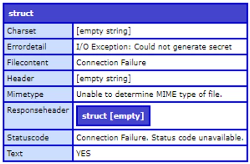

We have recently update our ColdFusion 2016 install to 2018 on two load balanced RHEL 7.9 servers. Both servers are currently running CF2018 Update 7 with Java version 11.0.10 and we are having issues with making cfhttp calls to various HTTPS sites like Google and Facebook.
These cfhttp calls work fine when CF is restarted but we eventually see errors like "I/O Exception: Could not generate secret" , "I/O Exception: Peer not authenticated", and "I/O Exception: Couldn't kickstart handshaking". After updating to Update 7, here's the more prominent error we've seen:

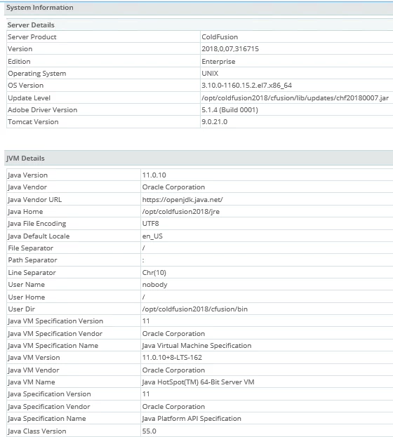

    Erik, your problem really sounds like you have NOT update the JVM. I realize you say you updated to Java 11.0.10, but could you confirm for us that your CF really is using that? (I've seen people install a new JVM on the box and mistakenly presume that CF would "just use it".)
    If you go to the "settings summary" pge in the CF Admin (the link right next to the "java and jvm" link), that has two sections at the top, and the second is the JVM info, and it reports the version CF is using. (You showed your CF's java args, but that doesn't confirm this for us.)
    If it's not showing 11.0.10, then the problem is that the JVM CF is using is NOT updated.  You will see on that page also that java.home which is how CF points to the JVM it uses. If you do have Java 11.0.10 installed, you can point CF to that. Do be careful, as if you make a mistake CF won't start. I have a blog post of many common problems that can happen in changing the JVM, and how to fix them.

    Feb 10, 2021 9:47 PM UTC
    Hello Charlie,
    I know we had a brief call where I confirmed the JVM version but wanted to update this conversation for historical reasons and in case it helps someone else.
    The Settings Summary page on both servers show the Java Version is 11.0.10 and Java Home is /opt/coldfusion2018/jre, which is where we imported the intermediate certs (/opt/coldfusion2018/jre/lib/security/cacerts).

    Feb 9, 2021 7:07 PM UTC
    This is kind of a wild guess, but I think you may have updated one of your keystores on one server but not on the other. I've usually seen this "MIME type" error when I don't have all of the certificate chain in the keystore (root CA plus intermediate CAs - you don't actually need the server certificate because that's provided as part of the TLS transaction). That would explain why it works when you initially restart the servers but doesn't work later - the initial CFHTTP calls are being made by the server with the updated keystore, the later ones aren't.
    Like I said, kind of a wild guess. Good luck!

    Feb 9, 2021 7:33 PM UTC
    Hi Dave,
    I did try importing the root CAs for a couple sites we have problems with but that didn't fix the issue. We setup test cfhttp pages that we can hit on each server individually so we know that once we restart CF on the server, it works fine.
    It seems to just build over time and eventually starts to throw the errors I mentioned.
