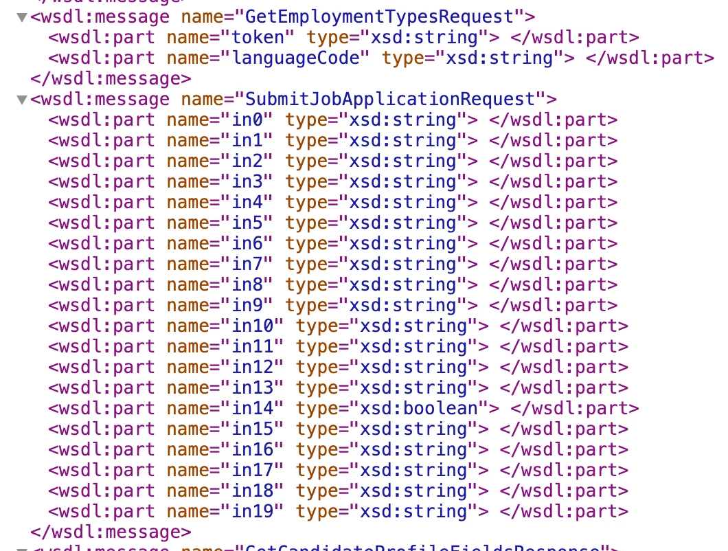

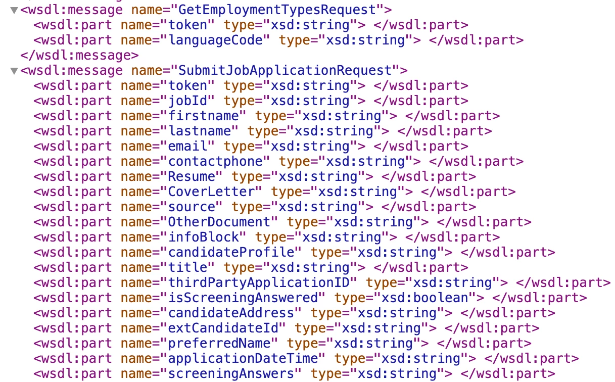

I have a legacy SOAP API built in Coldfusion. This API is well established and works most times, until it doesn't but just for some third parties integrating with it. The issue I am facing is quite odd, I have checked the logs but not able to pinpoint why it occurs or when.
This is what the API Method in question looks like when I access the wsdl directly from browser:
As you can see the parameters names for function SubmitJobApplocationRequest are defined and listed as expected; however quite regularly, after the API gets used for sometime (once again, I am not able to find out when it occurs unfortunately nor why it does), the parameter names change to the following:
At this stage, some of the third party software's integrating with this API get the following error message back from Coldfusion:
coldfusion.xml.rpc.CFCInvocationException: [coldfusion.runtime.MissingArgumentException : The TOKEN parameter to the SubmitJobApplication function is required but was not passed in.]
I originally believed that the issue could be caused by the parameters not being passed in the exact same order as what Coldfusion expects them to be, however the code snippets I have been provided by the developers from one of these third party softwares show the parameters being passed in the correct order.
The simplest solution I have found to fix the issue (until it occurs again) is to save the CFC template again by adding/removing a space anywhere within the template; it seems to be refreshing the wsdl perhaps?
Another thing to note is that we are using Coldfusion 2023 and we have recently upgraded from 2018 (and before then 2016) however we were already experiencing it, so it doesn't seem to relate to this upgrade process.
The server on which this API is hosted is not load balanced and there is only the 1 CF template in the folder.
Has anyone experienced the same issue with Coldfusion with the name of the parameters changing? Or anyone could suggest what I could look at to find out why it is happening?

    So there is a function in a web-service CFC. Its arguments are token, jobId, firstname, and so on.
    As the error message suggests, that function is actually SubmitJobApplication, not SubmitJobApplicationRequest. SubmitJobApplicationRequest is not created by the developer. It is an internal object that the WSDL engine creates to represent request-data. So it is up to the WSDL engine how it represents the data within the SubmitJobApplicationRequest  object.
    That said, it appears as if the order of the arguments may change from one web-service invocation to the next. That would be one reason why the engine would switch to generically named variables in0, in1, in2, and so on. Something else strengthens this hypothesis. Namely, the engine's use of the <wsdl:message> element to hold the arguments.
    I would expect to see something like
    <xs:element name="submitJobApplication">
    	<xs:complexType>
    		<xs:sequence>
    			<xs:element name="token" />
    			<xs:element name="jobId" "/>
    		</xs:sequence>
    	</xs:complexType>
    </xs:element>
    instead of
    <wsdl:message name="submitJobApplicationRequest" >
    	<wsdl:part name="token" ></wsdl:part>
    	<wsdl:part name="jobId" ></wsdl:part>
    </wsdl:message>
    Suggestion: ensure that
    1. each of the arguments of the function SubmitJobApplication is of simple-type.
    2.  every invocation of the function is on the basis of single arguments, rather than by means of a complex-type or argumentCollection.

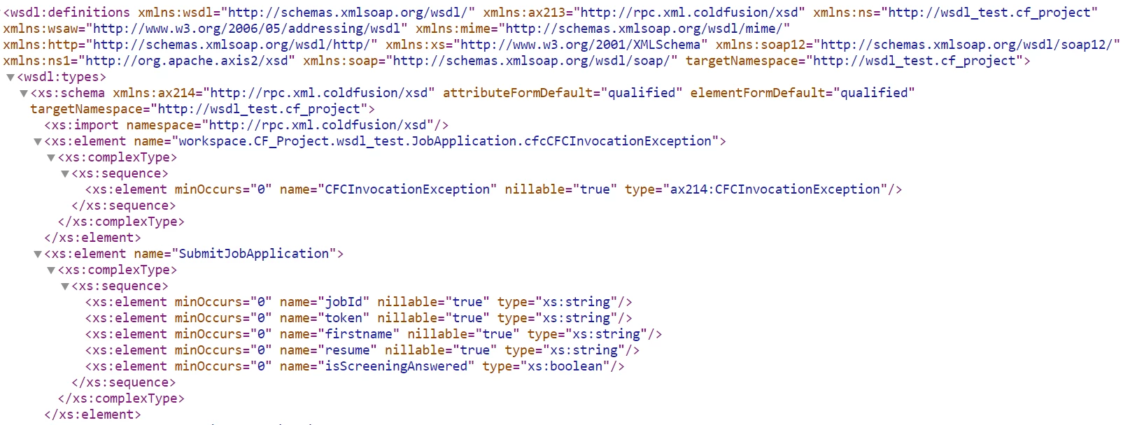

    Strange. I did a test, but was unable to reproduce your WSDL elements. Details of the test follow.
    Having checked on the web-service page in the ColdFusion Administrator that the version is 2, I created the following web-service CFC:
    <!--- Path under root: /workspace/CF_Project/wsdl_test/JobApplication.cfc --->
    <cfcomponent wsversion="2" >
    	<cffunction name="SubmitJobApplication" access="remote" returntype="String" output="no">
    		<cfargument name="jobId" type="string" required="yes">
    		<cfargument name="token" type="string" required="yes">
    		<cfargument name="firstname" type="string" required="yes">
    		<cfargument name="resume" type="string" required="no">
    		<cfargument name="isScreeningAnswered" type="boolean" required="no" default="false">
    		<cfset var wsResult="Job with ID " & arguments.jobId & " and Token " & arguments.token & ". " &
    		                     "Candidate's First Name: "  & arguments.firstname & ". " &
    		                     "Candidate's resume:" & arguments.resume & ". " &
    		                     "Is screening answered: " & arguments.isScreeningAnswered & "." >
    		<cfreturn wsResult>
    	</cffunction>
    </cfcomponent>
    When I launch http://localhost:8500/workspace/CF_Project/wsdl_test/JobApplication.cfc?wsdl I get the following WSDL:
    <wsdl:definitions xmlns:wsdl="http://schemas.xmlsoap.org/wsdl/" xmlns:ax213="http://rpc.xml.coldfusion/xsd" xmlns:ns="http://wsdl_test.cf_project" xmlns:wsaw="http://www.w3.org/2006/05/addressing/wsdl" xmlns:mime="http://schemas.xmlsoap.org/wsdl/mime/" xmlns:http="http://schemas.xmlsoap.org/wsdl/http/" xmlns:xs="http://www.w3.org/2001/XMLSchema" xmlns:soap12="http://schemas.xmlsoap.org/wsdl/soap12/" xmlns:ns1="http://org.apache.axis2/xsd" xmlns:soap="http://schemas.xmlsoap.org/wsdl/soap/" targetNamespace="http://wsdl_test.cf_project">
    <wsdl:types>
    <xs:schema xmlns:ax214="http://rpc.xml.coldfusion/xsd" attributeFormDefault="qualified" elementFormDefault="qualified" targetNamespace="http://wsdl_test.cf_project">
    <xs:import namespace="http://rpc.xml.coldfusion/xsd"/>
    <xs:element name="workspace.CF_Project.wsdl_test.JobApplication.cfcCFCInvocationException">
    <xs:complexType>
    <xs:sequence>
    <xs:element minOccurs="0" name="CFCInvocationException" nillable="true" type="ax214:CFCInvocationException"/>
    </xs:sequence>
    </xs:complexType>
    </xs:element>
    <xs:element name="SubmitJobApplication">
    <xs:complexType>
    <xs:sequence>
    <xs:element minOccurs="0" name="jobId" nillable="true" type="xs:string"/>
    <xs:element minOccurs="0" name="token" nillable="true" type="xs:string"/>
    <xs:element minOccurs="0" name="firstname" nillable="true" type="xs:string"/>
    <xs:element minOccurs="0" name="resume" nillable="true" type="xs:string"/>
    <xs:element minOccurs="0" name="isScreeningAnswered" type="xs:boolean"/>
    </xs:sequence>
    </xs:complexType>
    </xs:element>
    <xs:element name="SubmitJobApplicationResponse">
    <xs:complexType>
    <xs:sequence>
    <xs:element minOccurs="0" name="return" nillable="true" type="xs:string"/>
    </xs:sequence>
    </xs:complexType>
    </xs:element>
    <xs:complexType name="document">
    <xs:sequence>
    <xs:any/>
    </xs:sequence>
    </xs:complexType>
    </xs:schema>
    <xs:schema attributeFormDefault="qualified" elementFormDefault="qualified" targetNamespace="http://rpc.xml.coldfusion/xsd">
    <xs:complexType name="CFCInvocationException">
    <xs:sequence/>
    </xs:complexType>
    <xs:complexType name="StructDelegate">
    <xs:sequence>
    <xs:element maxOccurs="unbounded" minOccurs="0" name="entries" nillable="true" type="ax213:EntryDelegate"/>
    </xs:sequence>
    </xs:complexType>
    <xs:complexType name="EntryDelegate">
    <xs:sequence>
    <xs:element minOccurs="0" name="key" nillable="true" type="xs:anyType"/>
    <xs:element minOccurs="0" name="value" nillable="true" type="xs:anyType"/>
    </xs:sequence>
    </xs:complexType>
    <xs:complexType name="QueryBean">
    <xs:sequence>
    <xs:element maxOccurs="unbounded" minOccurs="0" name="columnList" nillable="true" type="xs:string"/>
    <xs:element maxOccurs="unbounded" minOccurs="0" name="data" nillable="true" type="ax213:ArrayOfObject"/>
    </xs:sequence>
    </xs:complexType>
    <xs:complexType name="ArrayOfObject">
    <xs:sequence>
    <xs:element maxOccurs="unbounded" minOccurs="0" name="array" nillable="true" type="xs:anyType"/>
    </xs:sequence>
    </xs:complexType>
    <xs:complexType name="DocumentDelegate">
    <xs:sequence>
    <xs:element minOccurs="0" name="document" nillable="true" type="ns:document"/>
    </xs:sequence>
    </xs:complexType>
    <xs:complexType name="ArrayDelegate">
    <xs:sequence>
    </xs:sequence>
    </xs:complexType>
    </xs:schema>
    </wsdl:types>
    <wsdl:message name="SubmitJobApplicationRequest">
    <wsdl:part name="parameters" element="ns:SubmitJobApplication"/>
    </wsdl:message>
    <wsdl:message name="SubmitJobApplicationResponse">
    <wsdl:part name="parameters" element="ns:SubmitJobApplicationResponse"/>
    </wsdl:message>
    <wsdl:message name="workspace.CF_Project.wsdl_test.JobApplication.cfcCFCInvocationException">
    <wsdl:part name="parameters" element="ns:workspace.CF_Project.wsdl_test.JobApplication.cfcCFCInvocationException"/>
    </wsdl:message>
    <wsdl:portType name="workspace.CF_Project.wsdl_test.JobApplication.cfcPortType">
    <wsdl:operation name="SubmitJobApplication">
    <wsdl:input message="ns:SubmitJobApplicationRequest" wsaw:Action="urn:SubmitJobApplication"/>
    <wsdl:output message="ns:SubmitJobApplicationResponse" wsaw:Action="urn:SubmitJobApplicationResponse"/>
    <wsdl:fault message="ns:workspace.CF_Project.wsdl_test.JobApplication.cfcCFCInvocationException" name="workspace.CF_Project.wsdl_test.JobApplication.cfcCFCInvocationException" wsaw:Action="urn:SubmitJobApplicationworkspace.CF_Project.wsdl_test.JobApplication.cfcCFCInvocationException"/>
    </wsdl:operation>
    </wsdl:portType>
    <wsdl:binding name="workspace.CF_Project.wsdl_test.JobApplication.cfcSoap11Binding" type="ns:workspace.CF_Project.wsdl_test.JobApplication.cfcPortType">
    <soap:binding transport="http://schemas.xmlsoap.org/soap/http" style="document"/>
    <soap:operation soapAction="urn:SubmitJobApplication" style="document"/>
    <wsdl:input>
    <soap:body use="literal"/>
    </wsdl:input>
    <wsdl:output>
    </wsdl:output>
    <wsdl:fault name="workspace.CF_Project.wsdl_test.JobApplication.cfcCFCInvocationException">
    <soap:fault use="literal" name="workspace.CF_Project.wsdl_test.JobApplication.cfcCFCInvocationException"/>
    </wsdl:fault>
    </wsdl:operation>
    </wsdl:binding>
    <wsdl:binding name="workspace.CF_Project.wsdl_test.JobApplication.cfcSoap12Binding" type="ns:workspace.CF_Project.wsdl_test.JobApplication.cfcPortType">
    <soap12:binding transport="http://schemas.xmlsoap.org/soap/http" style="document"/>
    <soap12:operation soapAction="urn:SubmitJobApplication" style="document"/>
    <wsdl:input>
    <soap12:body use="literal"/>
    </wsdl:input>
    <wsdl:output>
    </wsdl:output>
    <soap12:fault use="literal" name="workspace.CF_Project.wsdl_test.JobApplication.cfcCFCInvocationException"/>
    </wsdl:fault>
    </wsdl:operation>
    </wsdl:binding>
    <wsdl:service name="workspace.CF_Project.wsdl_test.JobApplication.cfc">
    <wsdl:port name="workspace.CF_Project.wsdl_test.JobApplication.cfcHttpSoap11Endpoint" binding="ns:workspace.CF_Project.wsdl_test.JobApplication.cfcSoap11Binding">
    <soap:address location="http://localhost:8500/workspace/CF_Project/wsdl_test/JobApplication.cfc"/>
    </wsdl:port>
    <wsdl:port name="workspace.CF_Project.wsdl_test.JobApplication.cfcHttpSoap12Endpoint" binding="ns:workspace.CF_Project.wsdl_test.JobApplication.cfcSoap12Binding">
    <soap12:address location="http://localhost:8500/workspace/CF_Project/wsdl_test/JobApplication.cfc"/>
    </wsdl:port>
    </wsdl:service>
    </wsdl:definitions>
    The section containing the arguments looks different from yours:
    I am therefore curious what WSDL you will get if you run my CFC. To do so, save the code as JobApplication.cfc. Then launch http://path/to/JobApplication.cfc?wsdl in a browser.
