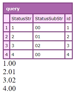

    A test in ColdFusion 2021 Update 6:
    <cfscript>
        myQuery = queryNew("id,StatusStr,StatusSubStr","Integer,integer,varchar",
                            {id=1,StatusStr=1,StatusSubStr="00"},
                            {id=2,StatusStr=2,StatusSubStr="01"},
                            {id=3,StatusStr=3,StatusSubStr="02"},
                            {id=4,StatusStr=4,StatusSubStr="00"}
        writeDump(myQuery);
    </cfscript>
    <cfoutput query="myQuery">
    	#StatusStr#.#StatusSubStr# <br>
    </cfoutput>
    The output is:
    Apr 18, 2023 5:29 PM UTC

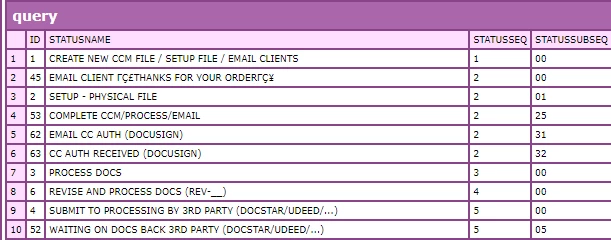

    Thank you.  I was pretty sure it was happening in CF but your test was a good idea.  The result of the dump is:
    so you can see it's returning the string "00"
