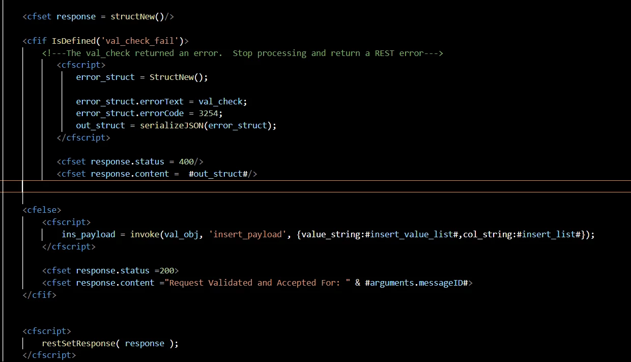

I am using CF REST Services and we would like to send back a detailed error struct when a requestor submits data that does not pass our internal validation check. I am using setRestResponse to manipulate the status code (which works fine on all accounts). However when someone fails validation I would like to send a struct back to the user with a 400 or a 401. My research lead me to putting the struct in the "content" part of my return struct to setRestResponse however when I do that, I get the correct statuscode but not the JSON struct of the error detail.
One thing Im observing is my api seems to be returning HTML, even though I have set the "produces" attribute of my function to "application/json". I have also set the function to void since we are using setRestResponse. Can you help me figure out how to send back an error detail struct with a 400 error? What exactly needs to happen to make the API respond with JSON beyond what Ive done already?
Ive included a snippet of my code.

    That said my problem is specfically here (all othter parts of this function work fine, and yes, it is a REST function using returntype="void").  If the validation check (variables.val_check_vail) fails, I want to send a 4XX statuscode error and an error payload.  When I do this for a 2XX statuscode, I can successfully send the payload structure with it.  When I do this for a 4XX this seems to somehow be overridden and the server returns HTML (despite my setting produces="application/JSON") with the generic 4XX error, and no payload structure.  Could this be the webserver overriding ColdFusion on errors and not success statuscodes?  If that is the case, how do you override it if your function is set to returntype="void".  Can I send a structure back in the "content" variable when using a 4XX statuscode and restSetResponse()?
    <cfif IsDefined('variables.val_check_fail')>
                    <!---The val_check returned an error.  Stop processing and return a REST error--->
                       <cfscript>
                           error_struct = StructNew();
                           error_struct.errorText = val_check;
                           error_struct.errorCode = 3254;
                           out_struct = serializeJSON(error_struct);
                       </cfscript>
                       <cfset response.status = 400/>
                       <cfset response.content =  #out_struct#/>
                       <Cfset pyld = response/>
                <cfelse>
                     <cfscript>
                        success_struct = StructNew();
                        success_struct.message =  "Validated and Accepted For: " & #arguments.messageID#;
                        out_struct = serializeJSON(success_struct);
                    </cfscript>
                    <cfset response.status =200>
                    <cfset response.content = #out_struct#>
                    <cfset pyld = response/>
                </cfif>
              <cfscript>
                    restSetResponse( pyld );
                </cfscript>

    Here is my entire function for reference.
       <cffunction name="putRequest" access="remote" produces="application/JSON" returntype="void" httpmethod="POST" restpath="/sendRequest" >
                <cfargument name="messageID" required="true" restargsource="query" restargname="messageID"/>
                <cfargument name="message" required="true" restargsource="query" restargname="message"/>
                <cfscript>
                    msg = Trim(arguments.message);
                    dec_obj = CreateObject('component', 'cfc.encryption');
                    val_obj = CreateObject('component', 'cfc.system');
                    dec_dt = invoke(dec_obj, 'dec_data', {data:#msg#});
                </cfscript>
               <cfset dec_msg = DeserializeJSON(dec_dt)>
               <cfset keyCount = StructCount(dec_msg)>
                <!---The below section should be included in a loop of the JSON or an interrogation of the struct.--->
                <!---Send the key/value pair to the validation library--->
                <cfset insert_list ="">
                <cfset insert_value_list = "">
                <cfset l_cnt = 0>
                <cfloop collection="#dec_msg#" item="key">
                    <cfscript>
                        val_check = invoke(val_obj, 'validation_library', {key:#key#, value:#dec_msg[key]#});
                    </cfscript>
                    <cfif val_check IS NOT "Pass">
                        <cfset val_check_fail = 1>
                        <cfbreak>
                    </cfif>
                    <cfset l_cnt = l_cnt + 1>
                    <cfif l_cnt IS keyCount>
                        <cfset insert_list = insert_list & key/>
                        <cfset insert_value_list = insert_value_list & "'" & dec_msg[key] & "'"/>
                    <cfelse>
                        <cfset insert_list = insert_list & key & ","/>
                        <cfset insert_value_list = insert_value_list & "'" & dec_msg[key] & "',"/>
                    </cfif>
                </cfloop>
                <cfset response = structNew()/>
                <cfif IsDefined('val_check_fail')>
                       <cfscript>
                       </cfscript>
                <cfelse>
                    <cfscript>
                        ins_payload = invoke(val_obj, 'insert_payload', {value_string:#insert_value_list#,col_string:#insert_list#});
                    </cfscript>
                    <cfscript>
                    </cfscript>
                </cfif>
                <cfscript>
                </cfscript>
        </cffunction>
    Oh, indeed. I have been able to reproduce the behaviour. The response goes to tags and XML format all of a sudden.
    Does it help when you include JSON content-type in the onRESTRequest event-handler in Application.cfc?
    <!--- Application.cfc --->
    component output="false"
        this.name = "RestTestApp";
        this.applicationTimeout = createTimespan(0,1,0,0);
        this.sessionTimeout = createTimespan(0,0,20,0);
        public any function onRESTRequest(string cfcname, string method, struct args) {
        	cfheader( name="Content-Type", value="application/json" );

    Below is my code
                       <cfscript>
                       </cfscript>
                <cfelse>
                    <cfscript>
                    </cfscript>
                    <cfscript>
                    </cfscript>
                </cfif>
                <cfscript>
                </cfscript>
