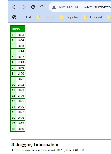

    Ok, there you go. It IS indeed a complex object, an array as you note. As for how it's happening, it was a change Adobe curiously (and quietly) introduced a couple of years ago (but then soon reverted). In CF2018 update 11 and CF2021 update 1, they started treating the multiple values of any form fields that had the same name as an array, instead of as a list as in the past. That seems to be what you're experiencing. This was reverted in CF2018 update 12 and CF2021 update 2.
    Technically, the feature is an old one, introduced in CF10, where Adobe also introduced a way to control that behavior, either with a cfapplication attribute for those using that and/or application.cfm, or as a property of application.cfc for those using that, called sameFormFieldsAsArray. Initially it defaulted to False. Only for that one update did it revert to defaulting to True. Since then, it again defaults to false.
    In any case, if you're getting an array and want a list, you'd want to set it to false. Don't make a mistake that I and many have, of leaving off the "s" after "field". It's:
    sameFormFieldsAsArray="false"
    And if you want to view what value is affecting your application, use cfdump to view the result of CF's getapplicationmetadata() function, which will report this sameformfieldsasarray being yes or no, depending on your setting or the default (it does not indicate if settings are set or picked up as defaults).

    so i put the abort right before the query and as suspected there was no error - i would not expect there to be because the line that caused the error did not run so thats good.
    Now i did the var dump  and i get this:
    array118632186431865418665186761868718698187091871101872111873121874131875141876151877161878171879181880
    so it appears it is an array? not sure how that is but it worked in CF11 so CF11 must have allow this and now is'nt?
    but i dont know how to fix it
    rickmazAuthor
    Aug 15, 2023 3:17 AM UTC
    This is the cf var dump that it is showing

    Well, we have to take your word for it that the error is indeed referring to that variable. Can you confirm that somehow? For instance, you could put a <cfabort> before the cfquery doing the sql update.  Does the error still happen? If not, that's NOT what's causing the error.
    Second and as important, don't rely on the debug output. At the same time as the above, and before the cfabort, put in a <cfdump var="#form.Product_ID#"> to see what is in that var right before trying that update. There are reasons the two results could vary.
