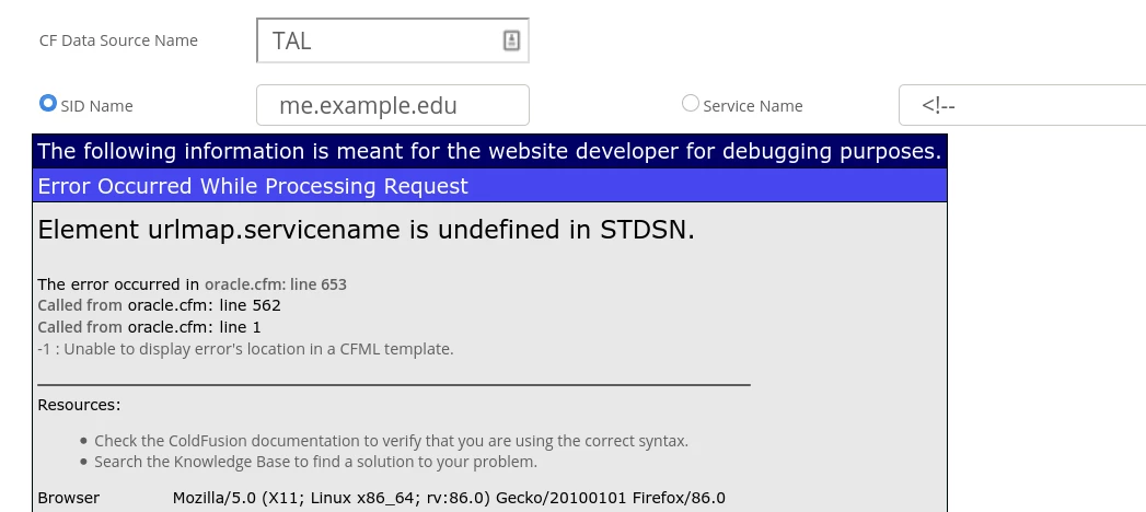

dejank52055655
Mar 8, 2021 8:19 PM UTC
Element urlmap.servicename is undefined in STDSN.
I imported the CF2018 setting using CFadmin package manager into newly installed CF2021 and now I'm getting a following error when I try to edit ORACLE specific Datasource. (MySQL and MS SQL are OK)
I recreated one datasource and it seems to be ok, however, I have over 200 DS's that would prefer not to recreate manually. CF is running on Centos 7.9, cf v2021. Any suggestions?

BKBK
Mar 12, 2021 12:53 PM UTC
@dejank52055655 : Element urlmap.servicename is undefined in STDSN.
I do believe this to be a ColdFusion bug. Hence my earlier suggestion that you report it.
The likely cause is the generation of corrupt neo-datasource.xml scripts.
BKBK
Mar 12, 2021 1:23 PM UTC
At first, I thought it was a bug in /CFIDE/administrator/datasources/oracle.cfm. But I can now prove it isn't. 🙂
To reproduce a similar error, simply point your browser to the page http://yourdomain/CFIDE/administrator/datasources/oracle.cfm.
The cause is therefore obvious. The part of your migration script neo-datasource.xml relevant to Oracle datasources has been corrupted. As a result, when you use the script, the ColdFusion Administrator datasource page posts incorrect form data.
In fact, you can see in the picture in your original post that an XML comment tag "<!--" is being posted as part of the Service Name. Such a corrupted form field value eventually causes an error in /CFIDE/administrator/datasources/oracle.cfm.
In short, you have to fix the migration script. Pay attention to the XML elements pertaining to Oracle datasources, to Service Name and to the location of XML comments. It might actually help to delete all the XML comments.

Charlie Arehart
Mar 9, 2021 10:08 PM UTC
Well, bummer. But I have a few more thoughts for you:
  • In doing the comparison of the neo-datasource.xml files, I will just note that there could be even a slight difference that might be missed. The key is having a good tool that can compare XML, especially that wddx-formatted XML that CF uses for its neo xml files. If you wanted to reach out to me directly (see my signature), and send me the two files, I could confirm your findings (there's no security risk about the passwords, because they are not only encrypted but with a key that only your CF instance would have).
  • As for the error, your screenshot shows an XML comment. There should be none in there by default. Are you sure there's not perhaps a problem whereby there could perhaps be a missing closing comment? or someone perhaps mistakenly used CFML comments (with 3 dashes) versus an XML comment (2 dashes), on either end of such a comment?
  • Have you tried running the XML through any sort of validation? That may help you spot something else amiss, tha tcould have been missed in eyeballing with a comparison (and if that comparison tool di dnot validate the XML, either)
  • If we can find no other explanation, then it would seem you ought to create a ticket at tracker.adobe.com. I just confirmed there are no others related to what you report, for CF2021 (looking either for "oracle" or "stdin")
