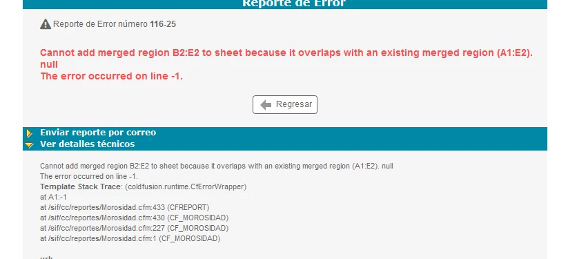

Hi all.
I recently had a problem with reports created with CFR when I try to open them in Excel with Coldfusion 2018, it has an error
"Invalid cell range, having lastRow  firstRow lastCol  firstCol, had rows 12  38 or cells 13 38 null "
or
"Cannot add merged region B2 E2 to sheet because it overlaps with an existing merged region A1E2 null
The error occurred on line 1. "
apparently there are problems with lines that have overlapping cells this did not happen in CF 2011- 2016 I would like to know if someone has had the same error or if this problem has been corrected in some way.

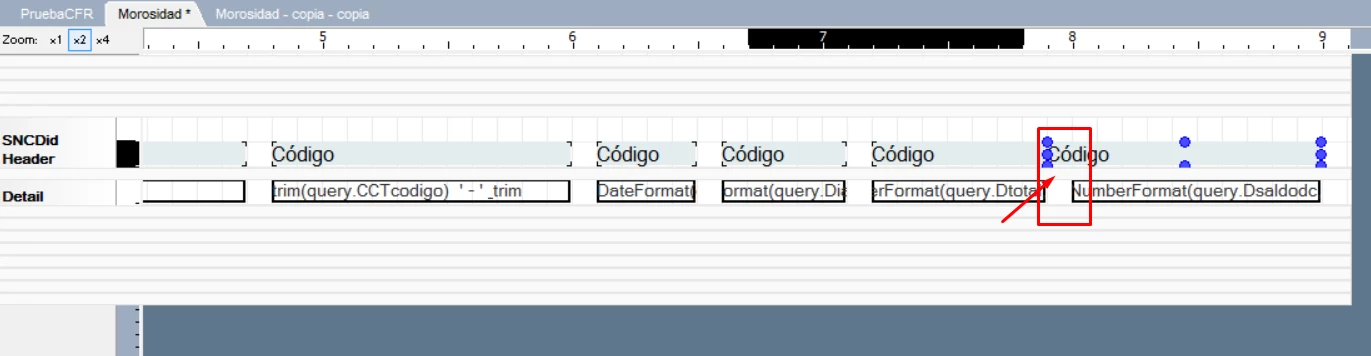

    I ran across this after a recent upgrade (CF11 to CF2018). I found the issue wasn't necessarily the fault of the upgrade, but a previously un-caught issue in our CFR file that generated the Excel file. We had a gap between columns in CFR that caused this error. Each column's (B) Layout → Left value should be the previous column's (A) Left value plus that column's (A) Width value.
    colA Left + colA Width = colB Left
    This needs to be addressed in the header row and details row.
