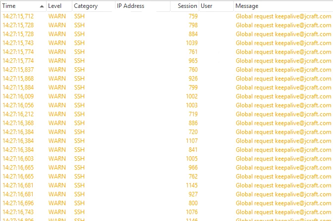

    Oct 20, 2021 7:05 PM UTC
    Hi Charlie,
    Thanks a lot for the help. I did check the connection variables and none of them are of the application or session scope. I am attaching the snapshot of the requests the client is recieving on their FTP server.
    And sorry to put it as "big drain on resources" which is a bit overboard, but that is how the client has been complaining about it. Thank you again for all the help.
    Charlie Arehart
    Oct 21, 2021 3:04 AM UTC
    Thanks for the clarifications. The messages being several per second certainly would be disconcerting. Here are more things to consider:
    • What are the attributes of your cfftp (other than username, password, and server)? Have you tried any alternatives for those attributes?
    • Also, let's narrow things down. You say this is a scheduled task that does a cfftp. What if you just do the open action, alone. Does that create these requests on their end? I realize that will take effort to coordinate with them. Track the time you do it, then tell them that time, and ask them to look in their logs. (You'll need to make sure you coordinate between your time and the server time.)
    • What about when you add whatever next CFFTP operation (from the request called via the scheduled task)? We need to figure out WHAT part of the CFFTP operation causes the problem.
    • You say the problem continues after the task is done. Do you have any monitor on CF that tells you whether the CF request is still running, after the task? It's possible. Similarly, the page you are calling (in the task) may be doing a cfthread to run the cfttp,  in which case it's running disconnected from the request itself. The CF PMT and FusionReactor monitors can watch cfthread operations.
