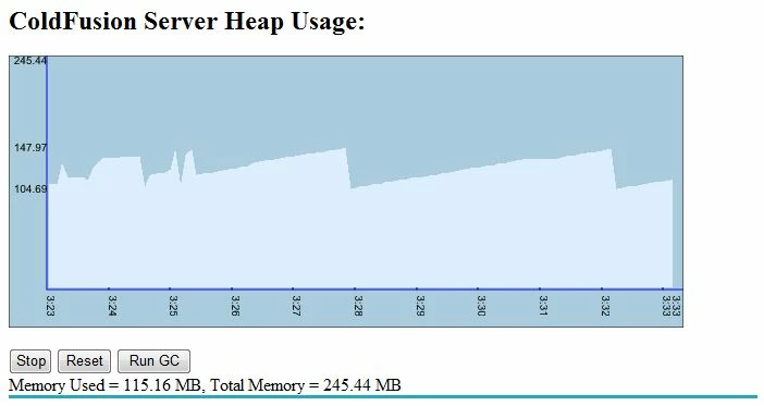

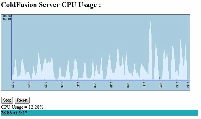

This ServerStats could help resolve JVM heap issues. No need to restart CF10 to apply JVM logging or JDK style Jconsole tools  to get a look at memory heap and CPU usage. Ref:
http://blogs.coldfusion.com/post.cfm/cfb-extension-for-server-stats-using-websocket
EG
Hope that’s helpful for readers, Carl.
