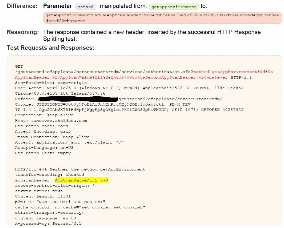

Hi, we recently had a security scan on one of our apps and we were dinged with "HTTP Response Splitting" issue. It occured on my .CFC pages. Below is what the testers performed on my CFC and the results.
I am running CF2018 Enterprise 2018.0.09.318650. I was curious if anyone had any suggestions on how to remediate this. My first step was to make sure "Enable Global Script Protection" was checked in the cfadmin, which it is. From there I believe the neo-security.xml file can be updated to help prevent CRLF injection, not sure what that would look like. Quite honestly I am not sure if that is the best or proper method. I get a little leary messing with some of the CF underlying files. Anyone have any other or better ideas?

    I noticed that the page was actually 404.  I performed a similar GET request against a CF2016 (non-enterprise) server to a non-existent CFC script and didn't see the extra response header returned.  I appended the following string to the URL param (I hope that I got it right) and it wasn't returned.
    %0d%0aAppScanHeader:%20AppScanValue%2f1%2e2%2d670%0d%0aSecondAppScanHeader:%20whatever
    Do you have any other technologies in front of the ColdFusion server?
    Which web server are you using?  (We use IIS.)
    Are you able to perform the test yourself on the server?
    Are you able to perform the same test on other known ColdFusion servers?

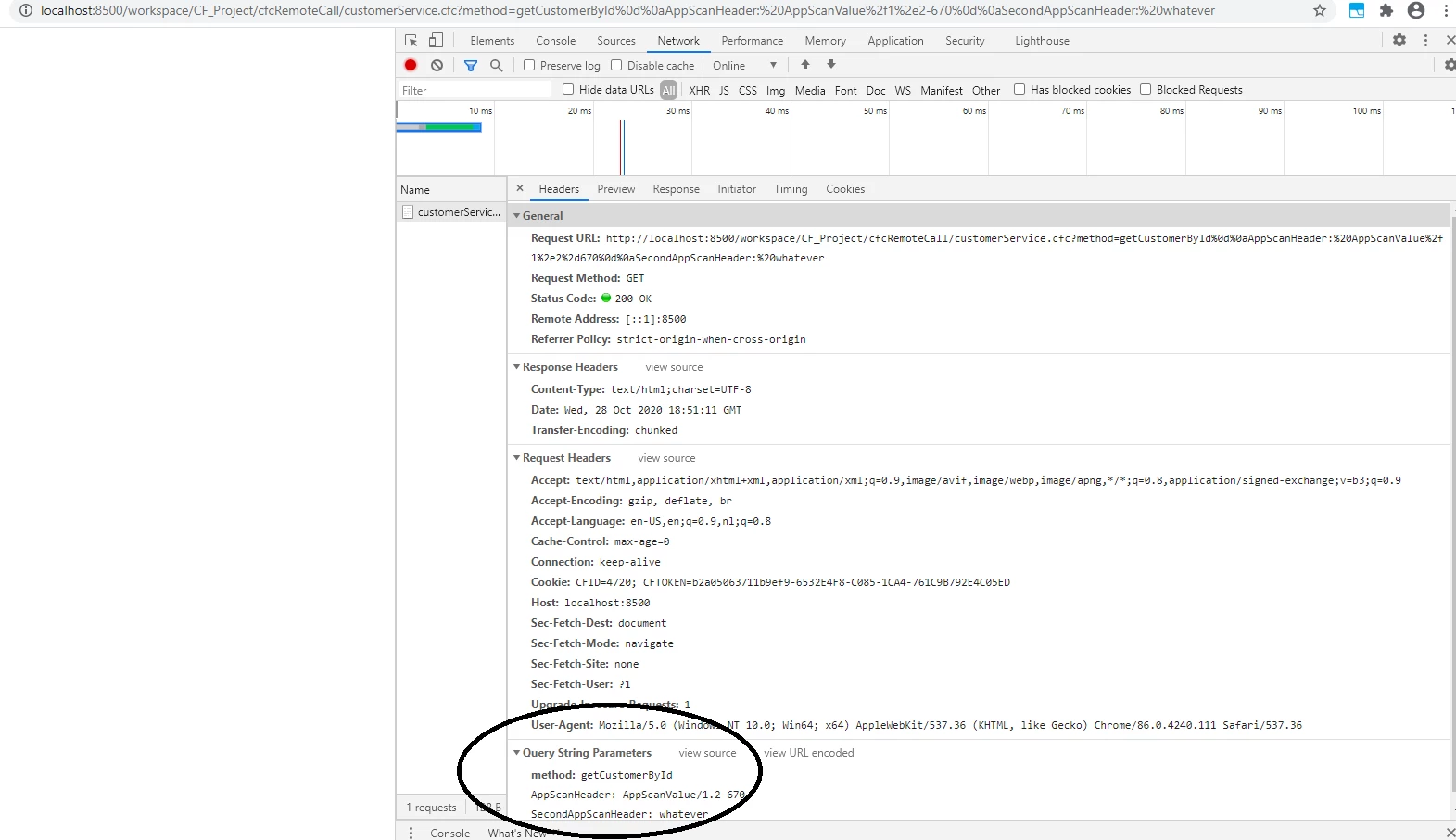

    Hi Jamo, we are running on top of WebSphere 9. I actually get a 403 forbidden error when I try to replicate what they did and I do not see those values in the request or response headers but only in the query string parameters from the URL. I am asking them to rescan to see if the issue still exists.

    BKBK
    Oct 28, 2020 6:59 PM UTC
    Same in my test. The 'AppScanHeader' values come out as query-string parameters.
