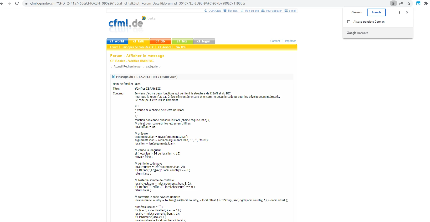

You will find ColdFusion code to verify IBAN at cfml.de.
Quite generous of Christian Henkel. If the code helps you, then please thank him at info[at]cfml.de.

Jul 3, 2022 11:18 AM UTC
@Jean-Marie22691987kfb3 , please note that, Google Translate interferes with the code, introducing errors! For example, the translation into French or English results in
REfind("[AZ][AZ]", local.country) == 0
which is wrong.
The correct statement is of course:
REfind("[A-Z][A-Z]", local.country) == 0
