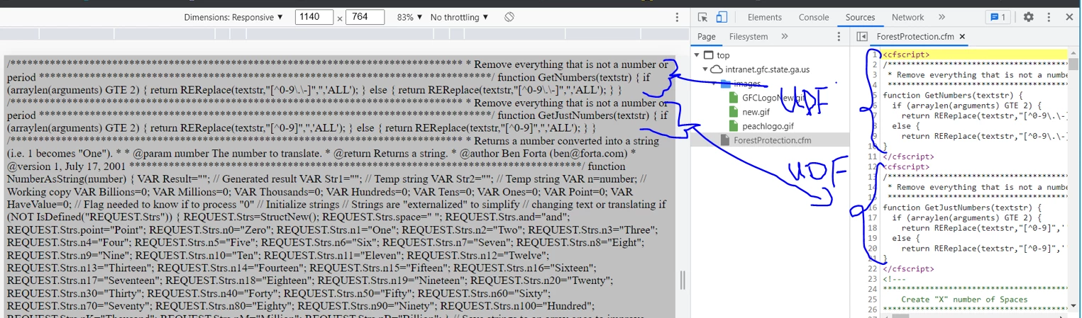

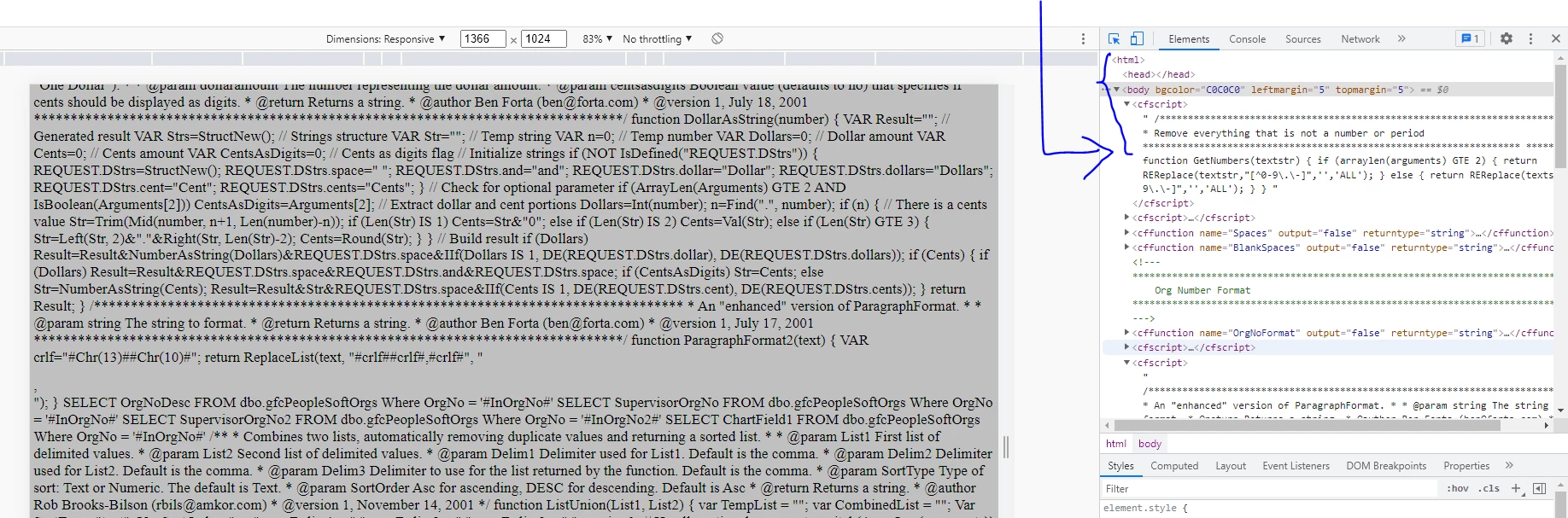

I scrolled the Elements section to the top.
I scroll the webpage to the top, and on the Sources section, "<html><head></head><body>" were probably above what is showed below.

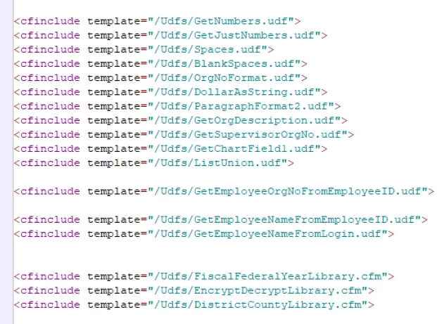

This is the section of my Application.cfm.

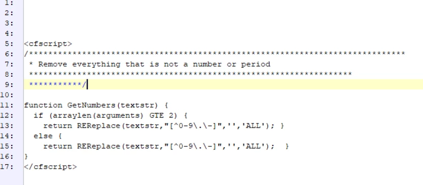

This is getnumbers.udf
So, I think my webpage is showing the content of UDF!

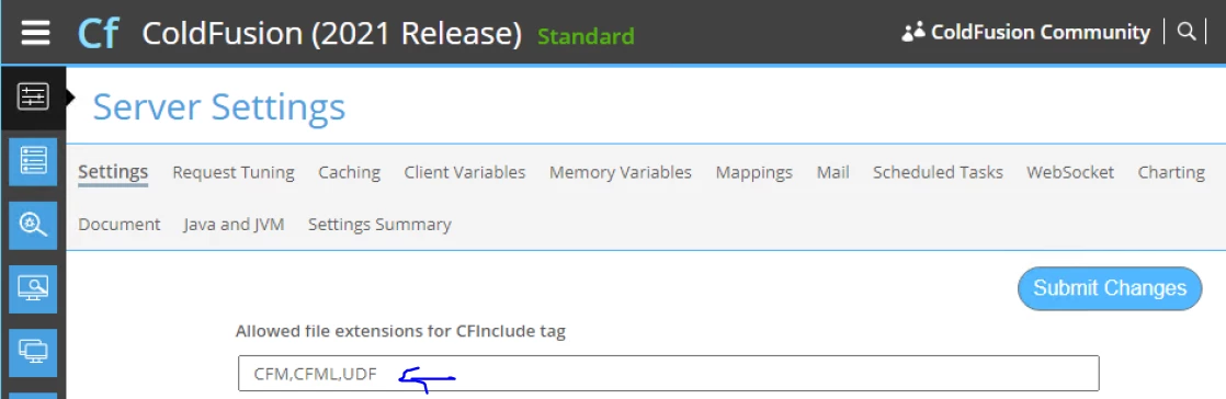

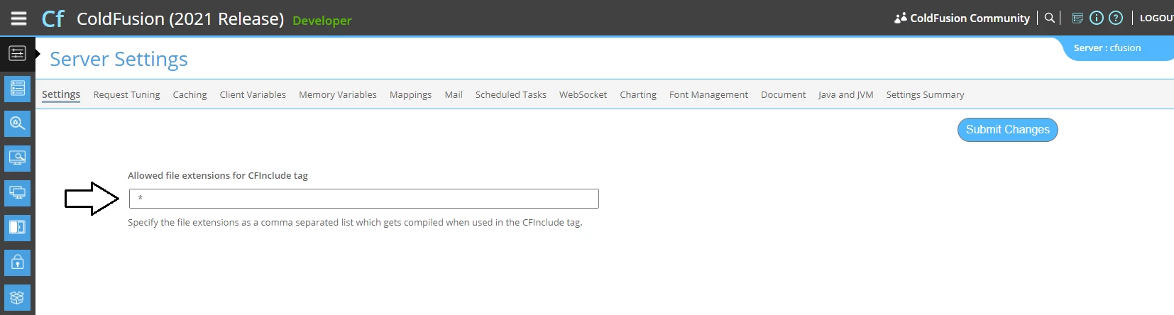

The cause is the UDF extension, as Charlie has said. ColdFusion simply parsed the included UDF files as static text, instead of compiling them. See the documentation on cfinclude.
I am surprised that that happened. (Assuming, of course, that you had not been playing with the this.compileExtForInclude setting in Application.cfm). I thought ColdFusion would compile every included page the default. That is, the default setting in the ColdFusion Administrator is *.
I have 2 suggestions:
  1. Manage the setting the ColdFusion Administrator. Use * or a comma-delimited list of file-extensions. My preference is *.  Afterwards, press the button to Submit Changes, then restart ColdFusion.
  2.  Convert your Application.cfm to its Application.cfc equivalent. Perhaps not now, but something to bear in mind for the future. Application.cfc is more modern and offers you many more possibilities.

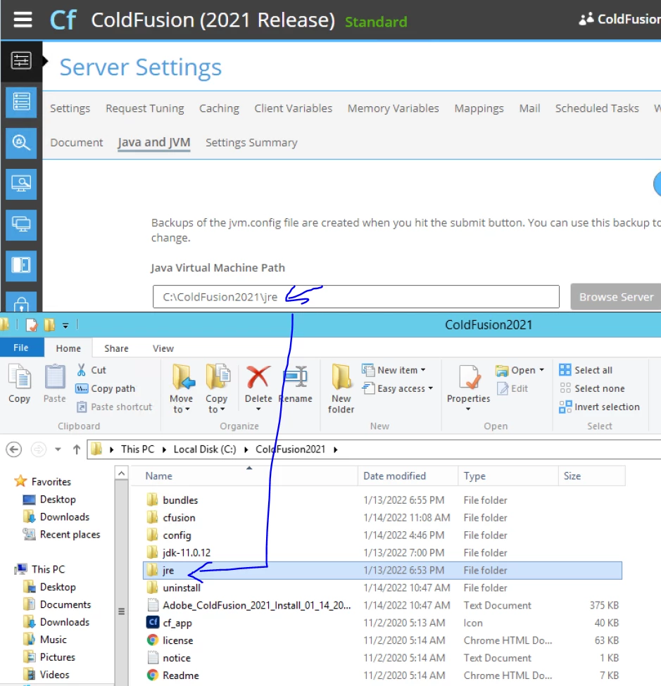

Is the above related to this setting?  Should I point the Java Virtual Machine Path to C:\ColdFusion2021\jdk-11.0.12, which was the setting in CF2018?

And yes, this almost surely will be solved by changing your CF to use a newer JVM. You have not said what JVM your CF2021 is using. If this was a CF2021 installer you got from Sept 2021 or forward, it came with Java 11.0.11. If instead, your CF2021 installer was from before, back to the original release in Nov 2020, THAT one mistakenly came with a pretty old JVM, 11.0.1.
Then note that the latest JVM is 11.0.14, which came out last week (and includes bug fixes, security fixes, and more). Adobe offers the two most recent JVM versions (for 11 and 😎 at https://www.adobe.com/support/coldfusion/downloads.html#additionalThirdPartyInstallers.
So to be clear, yes updating the JVM will almost certainly be the solution for you, whether to 11.0.12 or perhaps better to 11.0.14
Let us know how it goes.
