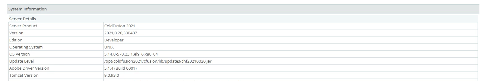

On my server, I've got a few scheduled tasks set up. Yesterday, after a while, I wanted one of the tasks to run at a different time. After doing the edits and clicking the "Submit Changes" button, I got this error:
Invalid extension of the file name. Valid extensions are :log,txt
Didn't have this issue before, so I am not sure what's causing it.
Here are the server details:
