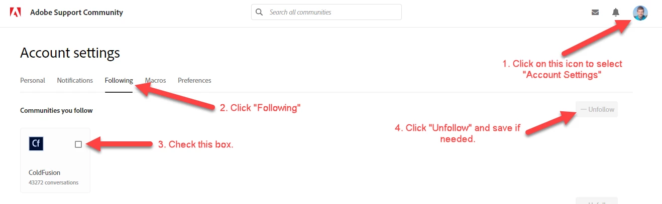

I want to cancel the subscription for this
Aug 25, 2021 3:34 PM UTC
Dave Watts, Eidolon LLC
