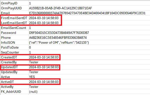

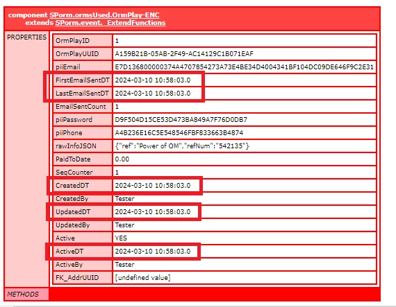

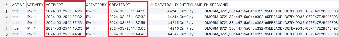

So, does anyone have a clue why coldfusion would return a different value from a mysql datetime?
I've got a 4 hour difference. Is there some setting I'm missing? Orm or Query. This is bizarre.
(Aside from cf adding in milliseconds of 0)
Orm record:
Database record:
Query records:
Database records:

Sorry, phpMyAdmin and dbVisualizer are 3 hours later. Time difference in coldfusion is 4 hours. Could this have something to do with Daylight Savings Time?
ColdFusion does not determine the timezone of third-party tools such as phpMyAdmin, dbVisualizer or MySQL. You should make sure that each individual tool is equipped with the required timezone. That is what I meant when I suggested  that you use UTC date-times "across the board."

Mar 26, 2024 1:31 PM UTC
@BKBK I agree that most likely it is the time zone. My datasource has this in the connection string "useTimezone=true&serverTimezone=UTC"
It was my understanding that that setting would convert the datetime/timestamps to UTC for the server.
However, I was NOT expecting a conversion on reading the data back.
If that is what it is doing, then anywhere I run my code would potentially return different values from the database, depending on location/time zone.
Any idea how to get the database server time to use in this code?
