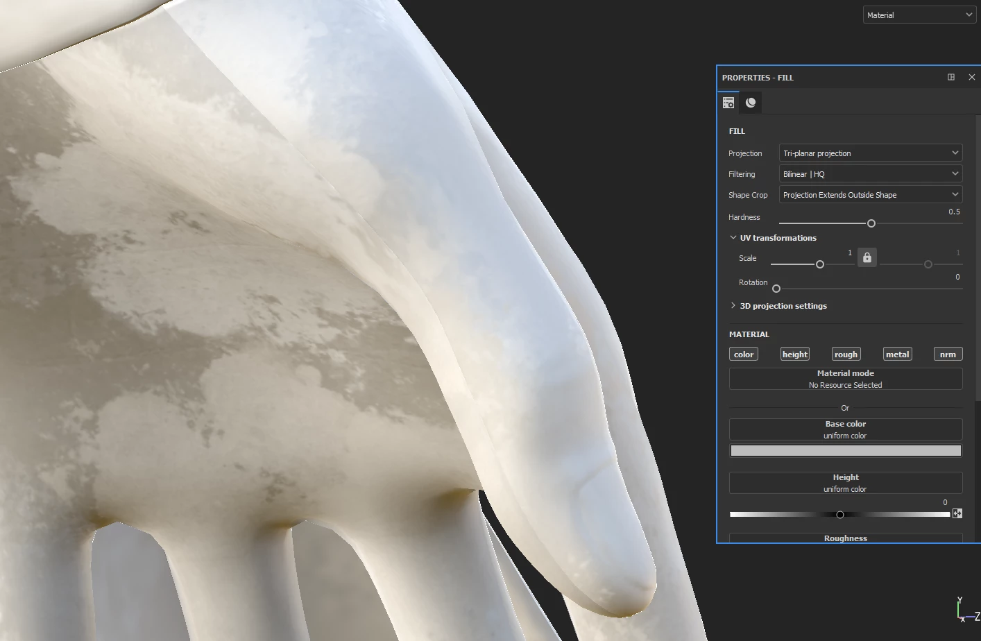

You can see the seams during texturing . how to fix it?
Hi, I start to texture my model and seams come out, I do not know how to fix it and they do not smear, what to do? Where you can see the seam in May is soft.
I used to make incisions on the soft, but the stitches were not visible, but now they came out and I can not remove them in any way please help me.
I understand that they can be covered up, but I want to learn how to fix these issues so that in the future there will be no problems.

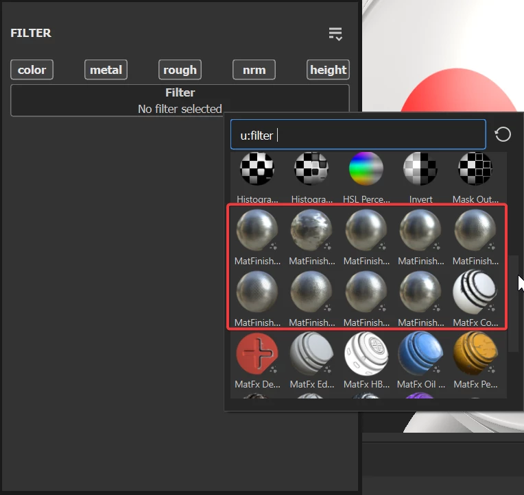

Secondly, there are known filters that will create visible seams. All the Matfinish, for example. Those filters directly influence the Normal map (not the height as we usually do in Substance 3D Painter), and it's complicated to make a seamless normal map, even with a Tri-Planar mapping.

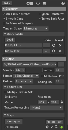

When baking your High Poly on your Low Poly, set up a decent amount of Dilation Width to avoid padding issues. You can also try to switch the type of padding under the Texture Set Settings.

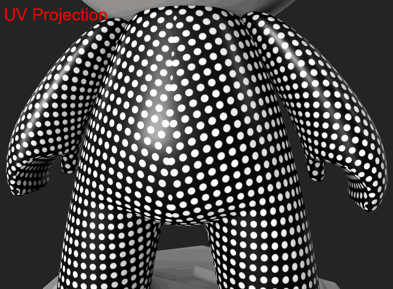

Lastely, make sure to follow a seamless workflow. If the textures are projected on the UVs, the seams will obviously be visible, but as long as you work with Tri-Planar (or a similar projection), this shouldn't be a problem.

jul. 31, 2023 1:16 PM UTC
Hello Cyril Dellenbach nothing helped, I redid yuv and still see the seams and also in substance also see the seam in three planar, here is my settings in marmoset, and where to find the settings for smoothing in marmoset 4 I just don't know much about it.
