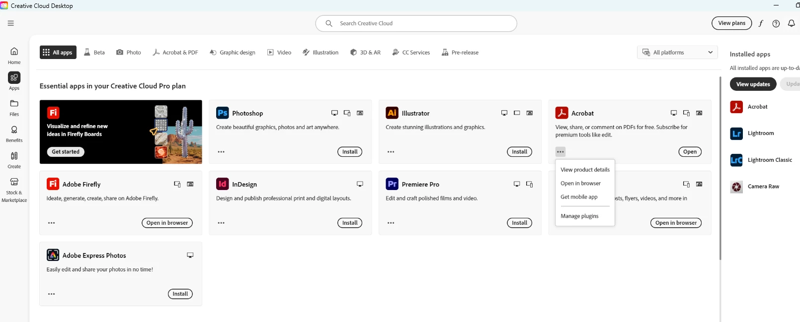

I've just re-installed the CC app and it is already saying my installed apps are Acrobat, Lightroom, and Camera Raw (but not Photoshop, the only app that will work).
When I hover over the 3 ellipses to the right of Acrobat under "Installed Apps" and choose "product details" and try to open it from there, nothing happens.

@kglad When trying to uninstall every cc app including preferences per the link you included (through cc, not my computer), I am not offered the ability to uninstall. Before I go any further I wanted to alert you to that.
