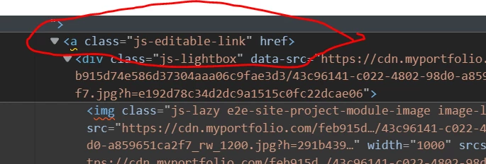

When I inspect the page, I can see that the href is somehow getting stripped when you publish the site.

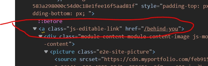

In the editor when inspecting, it looks like this: <a class="js-editable-lik" href="/behind-you">
When you inspect the same thing on the published site it looks like this: <a class="js-editable-lik" href>
Notice, no actual link in the href. Seems like a bug when you publish maybe... Anyone else see this?

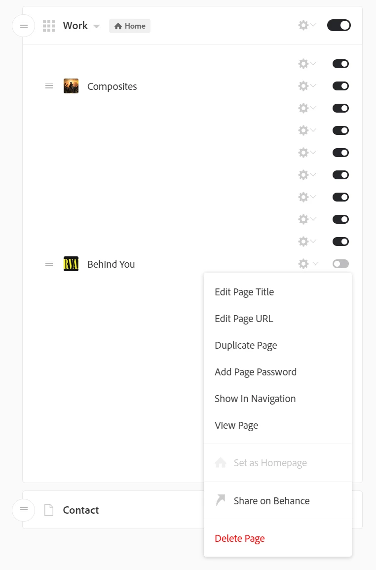

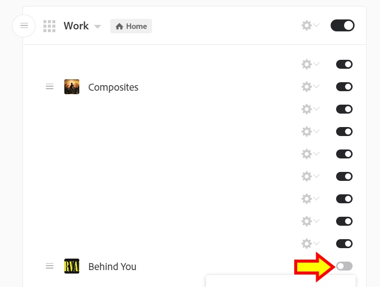

"Behind You" page is not activated.  It's gray.  Click the button to make it dark like the other pages.  See screenshot.
Click Publish Live Site button.
Refresh your browser (F5 or Ctrl+R) and examine the site.

Publish is for some reason stripping out the href. I can see it in the inspector. It's there in edit mode, gone in publish.
Edit mode inspector (href looks like it should):
Published inspector of same image link (href is malformed, or doesn't exist):
