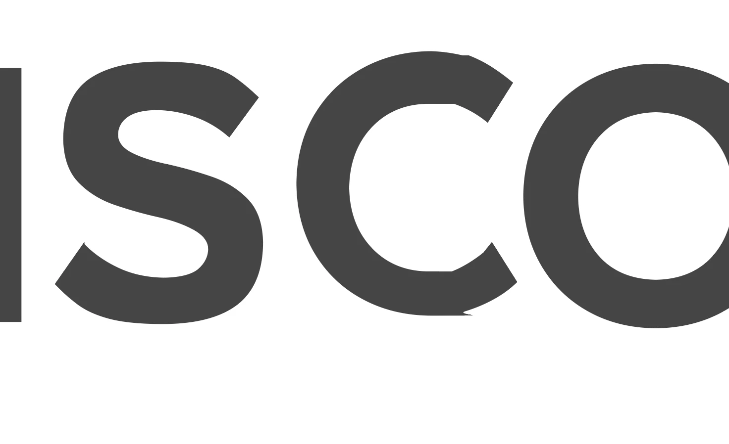

This has been a known problem for a while—I'm seeing posts from at least 2020 with this issue. I try to have my designers keep an eye out for our logos, and we will typically pull a fresh vector from the OG file. But how can I hand over logo files to an Express user who doesn't have the eye to notice a problem when the libraries are still distorting vector files? This is not at all acceptable. Fix the Creative Cloud Libraries!

Oct 22, 2025 2:56 PM UTC
Mac OS Tahoe 26.0 (25A354) and versions below, members on my team are not on Tahoe yet.
Adobe Illustrator 29.8.2

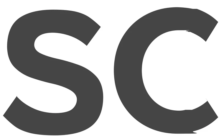

The distortion occurs on placing from the library and opening from the library. All users on the team are experiencing the same problem. I have replaced graphics with new files and ultimately end up having the same problems. It has been occuring for at least three years. The most recent files were not created by me, but have some extra points in the vectors. Which might be a cause, but the type that wasn't edited has some distortion. I do not have "snap to" turned on. And I don't know if the original files had it turned on. Exported a distorted vector and attached. The C is the main problem but the S have been affected.

Oct 20, 2025 10:06 PM UTC
Sep 24, 2025 3:36 PM UTC
I'm also on the team. I just tried opening the CC library file, deleted the distorted vectors, imported clean OG vectors, and saved it again (because it might be linked to projects), but the issue appears AGAIN after saving, this time slightly different distortions!
