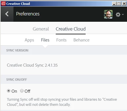

Hi Chet,
This issue has been addressed now. You should no longer receive the error if you have the latest version of the Creative Cloud app installed. You can confirm you have the latest version from the Creative Cloud > Files section of the preferences. If you have Creative Cloud Sync 2.4.1.35 or later, the issue should be resolved.
Here are instructions for accessing the preferences if you need them.
Use the Creative Cloud desktop app to manage your apps and services

Aug 22, 2017 4:16 AM UTC
According to here, the version you mention is not yet released. Trying to update the desktop app seems to confirm this.
David__B
Aug 22, 2017 2:52 PM UTC
Hi Chet,
There are different versions for Creative Cloud desktop app itself versus the Creative Cloud Sync. In the latest versions of the desktop app the sync version is listed in the Creative Cloud > Files portion of the preferences.
