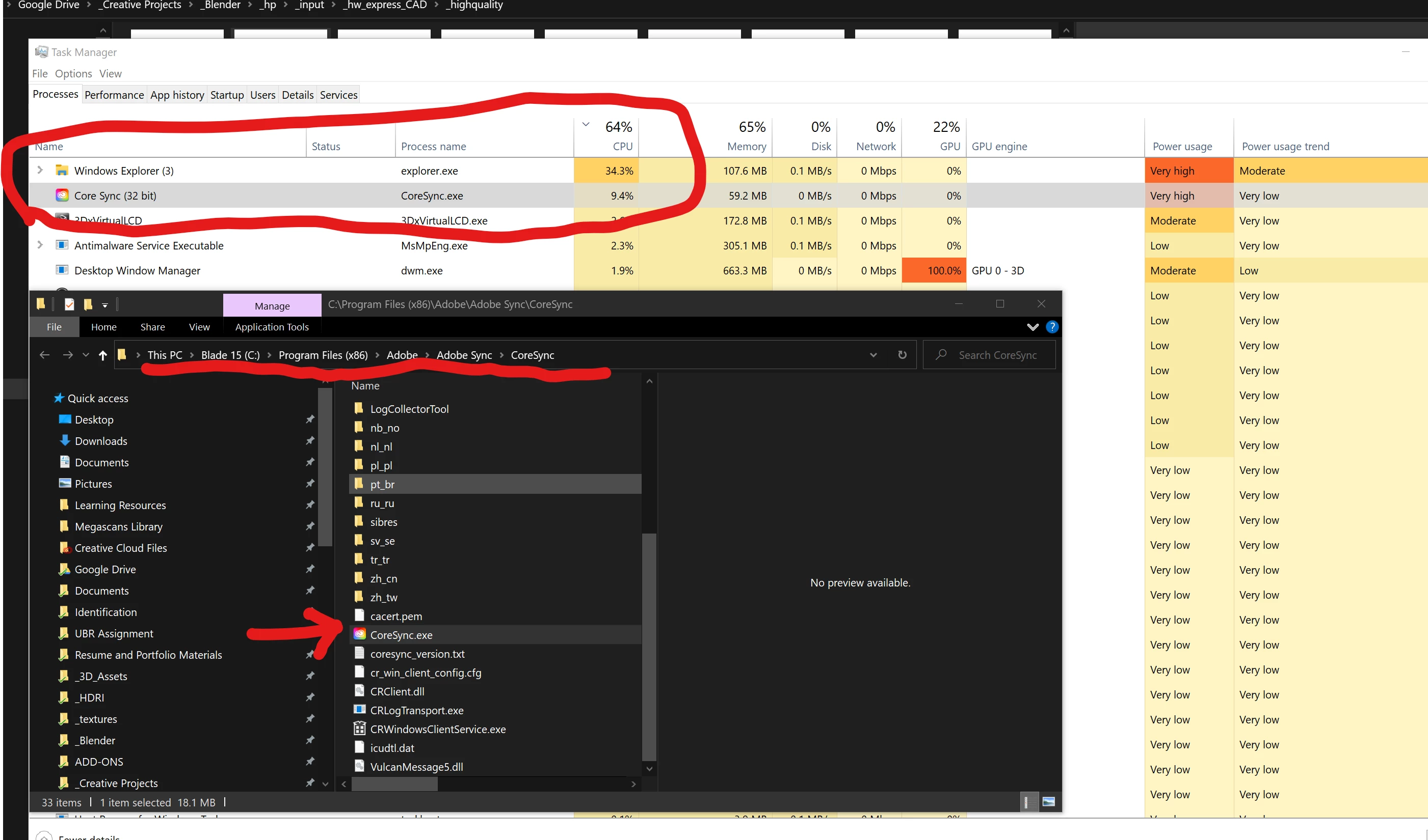

This will probably get me booted off or trigger some mod--but since the only other relevant post for this issue dealing with Windows 10 users is locked, I just wanted to echo and get known that this bug is still on Win10 as of this post.
Specifically, CoreSync.exe causes Explorer.exe to run super high at about 40% cpu usage, while CoreSync.exe itself hovers around 15%. The second I kill Creative Cloud deskopt app or the CoreSynx.exe process? Explorer.exe returns to normal. These two are linked.
kglad
Mar 24, 2021 3:33 PM UTC
Mar 25, 2021 12:26 PM UTC
The CoreSync app is the legit Adobe app, as confirmed by Opening File Location from Task Manager. This is a bug.
