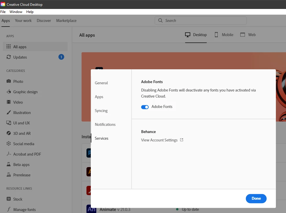

Core Sync is responsible for syncing data between your machine and Creative Cloud account. It also manages and syncs your fonts and Creative Cloud Libraries in other Adobe apps. Additionally, Core Sync syncs cloud documents created in applications like Adobe XD, Adobe Photoshop, and Adobe Illustrator.
if you pause file syncing, delete cloud documents* and turn off adobe fonts (file>preferences>services)**, does you bandwidth recover?
Mar 10, 2021 6:24 PM UTC
Thanks for your reply, I've tried all of the above and still no improvements 😞
