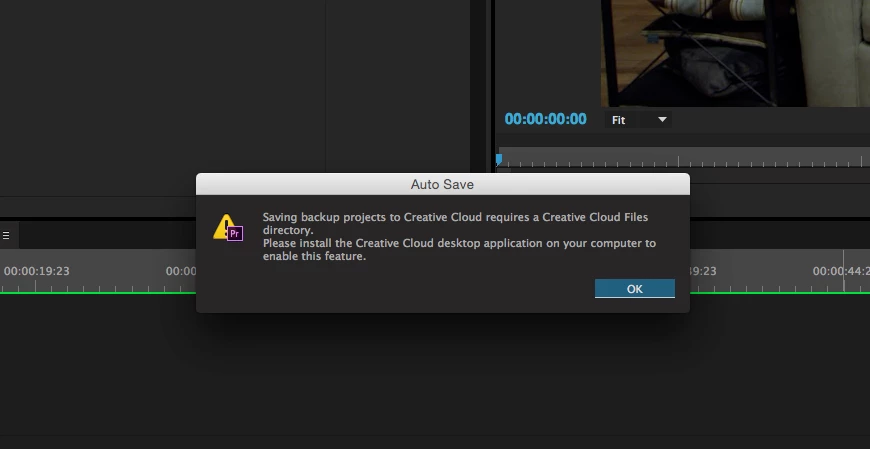

Aug 3, 2015 4:12 PM UTC
talked to someone at Adobe for a hour and they cant fix it- ever since the last CC update i cant use the file sync option
keeps saying "please install the creative cloud application to enable this feature"
