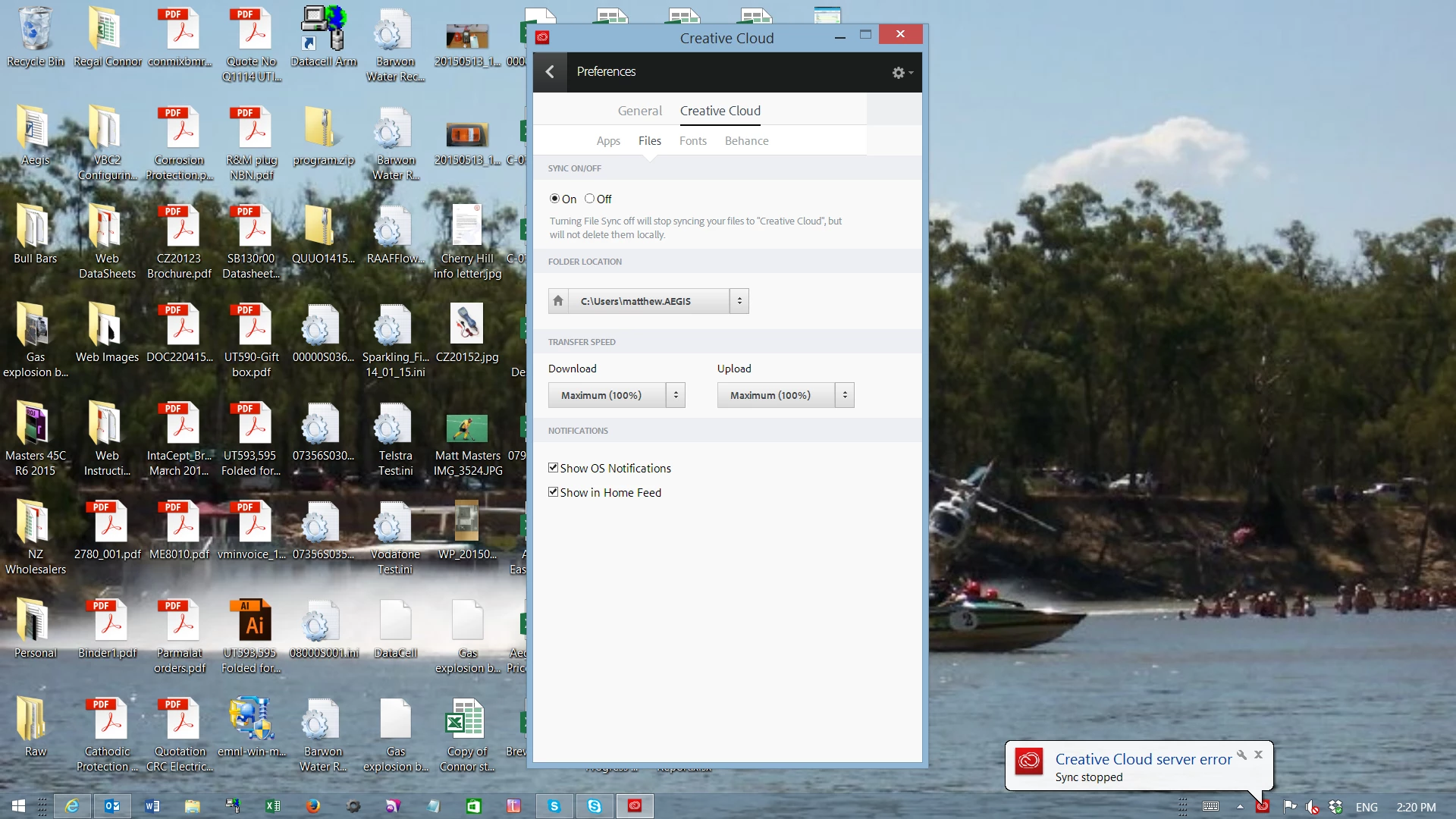

server error sync stopped
Ive tried reinstalling creative cloud but this hasn't fixed the problem. Any ideas ?

Jun 16, 2015 3:45 AM UTC
Can you post screenshot of error ?

Jun 23, 2015 2:32 PM UTC
We pushed an update on Sunday June 14th (V 2.1.1.110) that should fix the issue.  If not, please try deleting the db files following these steps:
1) Quit Creative Cloud Desktop App then the CoreSync and Adobe Desktop Service processes using Activity Monitor (Mac) or Task Manager (Win)
2) Navigate to:
WIN: C:\Users\<username>\AppData\Roaming\CoreSync on Windows
Note: The AppData folder is hidden by default this doc shows how to show it if needed, http://helpx.adobe.com/x-productkb/global/show-hidden-files-folders-extensions.html
3) Then delete any file that end in .db,.db-shm or db.wal, and re start Creative Cloud (There should be 3 or 4 files, but could be more if you have multiple accounts signing into CreativeCloud)
4) Restart Creative Cloud Desktop
