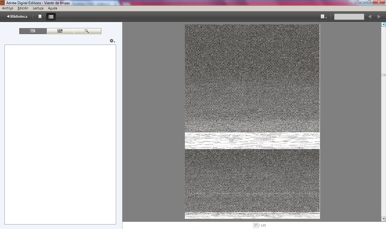

Hi, version 4.5.7 is having problems opening certain PDFs. Could you enable the download of version 4.5.2 with which this problem does not occur?

I'll also say that it is pathetic that Adobe can't fix this in a timely manner, I've found posts back in November about this issue.
They should at least tell people that PDF backwards compatibility is the issue.  I was lucky enough to have found a tip that recommended turning off v4 acrobat compatibility when exporting from InDesign.  Our publication was originally in Quark, so I had to turn off v4 compatibility on the export in a different place, but that worked.
davids53056827
January 30, 2018
FYI, our solution was to re-export the PDF source file, and remove the option of Acrobat v4 compatibility.  Since version 7 is still pretty old, when we exported the publication to PDF we only allowed v7 compatibility, which wasn't out until 2005.
I figure if people need further backward compatibility, they can get a time machine.
