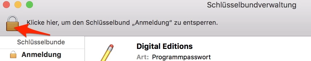

    Hi there, I had exactly the same* problem and the solution in my case was weird but essential:
    within the "keychain app", I needed to lock down "the lock" within the keychain app itself.
    Once I locked it, the Adobe authorisation process went through.
    *using a Mac
    Aug 12, 2018 8:50 PM UTC
    This HELPED for me!! Thank you sufenner​
