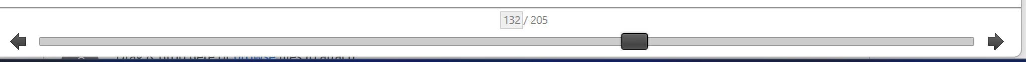

I found that if you hover over the bar that shows your page number, arrows and scrolling on the mouse will change the page, if you are not hoving over the bar, page up and page down are your only options outside of clicking the arrow to turn pages.
