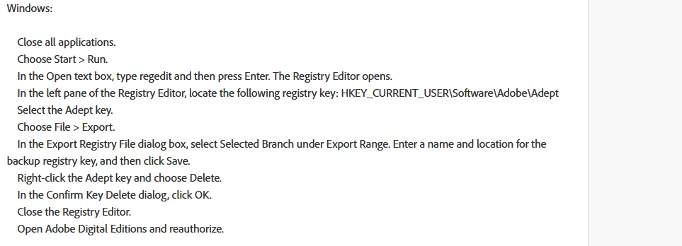

    I was having the very same problem.  I was able to correct this error on my Kobo glo by downloading ADE 3.0 instead of the newer version 4.5. I also erased the authorization information on my computer(windows using registry editor key) and on the device and then installed 3.0 and authorized first the computer then the kobo device. My DRM book is now readable on my kobo.  However, I don't feel that confident about this being a permanent fix so I will update it I experience this issue again.
